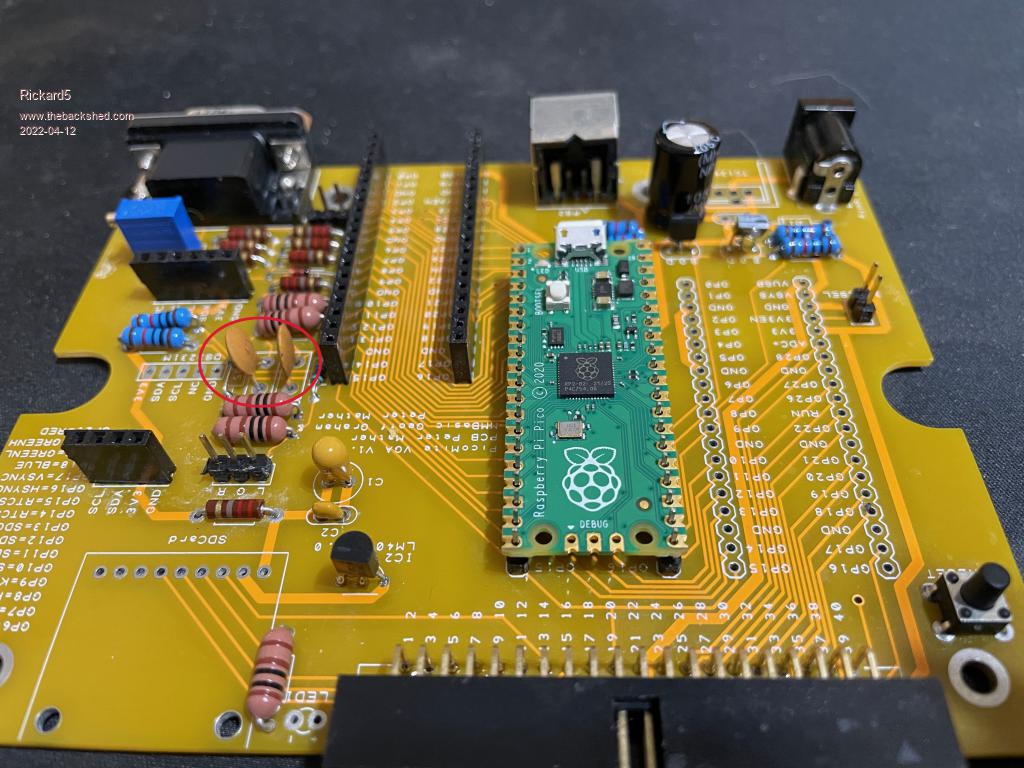

I got my parts Friday as it were ,  I will never order from NEWARK again if it Kills me, all my parts were dumped in a box with no packing and Crushed, but I HAD to Build this VGA Board even with a Broken Elbow. so I'm moving along at the speed of Smell, and I've run out of parts, I'm make a run to Mouser (ABOUT AN HOUR EACH WAY)
hopefully in a day or 2 to get the rest of what I need :) But my Questions are can I use these kind of caps seen circled in red for c25 and C26 instead of the ones shown in the build pic?
Also can put the Pico in the position shown? my goal is to run a MICRO USB TO PANNEL MOUNT USB B so I don't have to plug and unplug the pico for every update as the Micro USB is the point of Failure

- Ceramic capacitors are 'not preferred' for audio use but should be OK.
- According to the schematic, all three Pico connectors are in parallel so that should be OK.

FYI the audio coming out of that board is line level audio. You can connect 32 ohm headphones to the 3 pin header, but the audio volume is low. I had a discussion about this with Peter and Mick (Mixtel) a week or two back on this forum.
