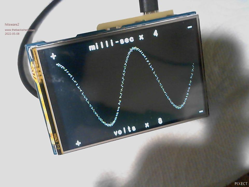

So Last night I sold my soul. I may be going to the fiery place below, went to that book store Captain Kirk  runs like a Chinese Labor Camp, and was looking for an ILI19488 LCD for a PM Project I have in my mind when Low and Behold I found  This  Please tell me this will work I drunk bought 2  of them

See manual page 43.
hitsware2
Joined: 03/08/2019
Posts: 738
Posted: 11:27pm 07 May 2022
Those work great ! So much easier than trying to sort
through the SPI wires
