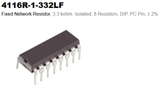

What is really required?
I am only driving a Pico's input from an external 24v. CTR is not an issue so I guess that the DS-stated LED If of 10mA is unimportant, correct? Really want to keep the resistor's power-rating to the minimum.

Tinine
Joined: 30/03/2016
Posts: 1646
Posted: 09:00am 10 May 2022
Thanks Mick
I was looking at 3.3K but I guess, with this format, I can easily test a variety:
