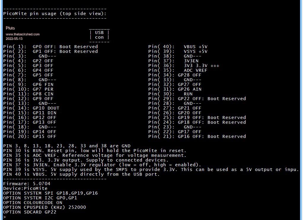

Made a small utility routine for checking the status of the PicoMite pins.

Corrected version:
Pin Info PicoMite.zip
When some options for SPI and I2C are set, the map will show that these are reserved on start-up and it is easy to see which pins are free for other usage.

Thanks for the code and thanks for the screen shot so we have a better idea of what it does.
