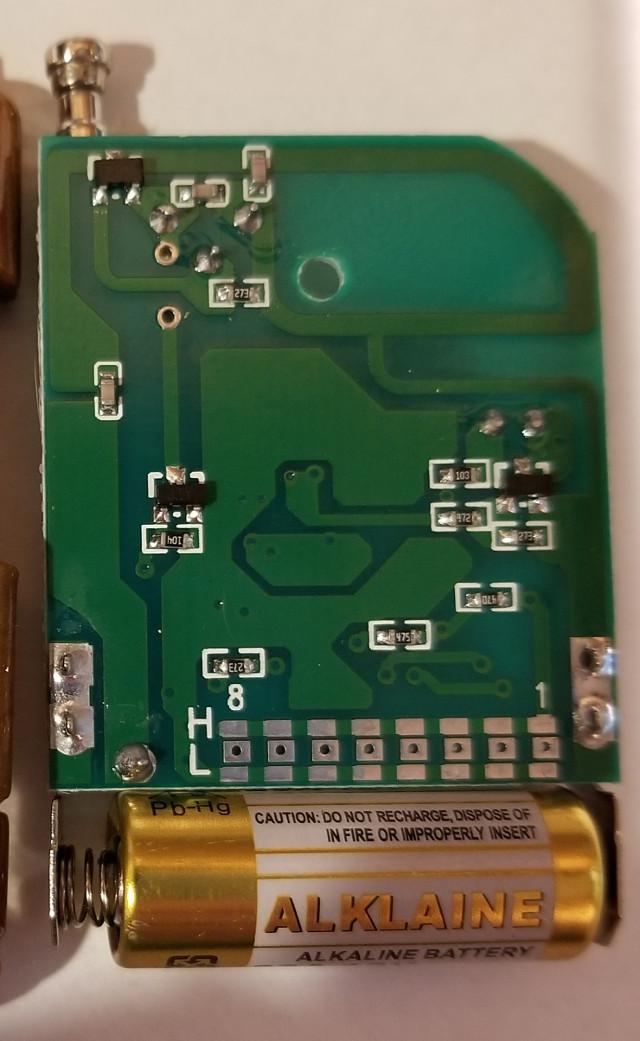

the earlier 433MHz transmitter fobs used jumpers to set the code, and, of course, shipped with all the jumpers left open (code=0). as i recall the devices had up to 12 code select pins, where each pin could be tied high, low, or left open. that is 3^12 = 531441 possible combinations. but setting a code required opening the fob and (randomly) adding solder blobs - i suspect most fobs just remained set to the default of 0
(from: https://community.home-assistant.io/t/how-to-generate-arbitrary-broadlink-rf-code/22430)
with the arrival of the EV1527, each having a random OTP code set at time of manufacture, this little 'security oops' was closed!
rob   :-)
addendum: both EV1527 (OTP) and PT2262 (jumper programmed) devices transmit 24-bit packets of data. for the EV1527 this consists of a 20-bit code + 4-bits of button data. with the PT2262 each pair of bits encode a 3-state pin (high, low, open); see page 7 in the below datasheet:
https://datasheet.lcsc.com/szlcsc/PT2262_C16390.pdf
