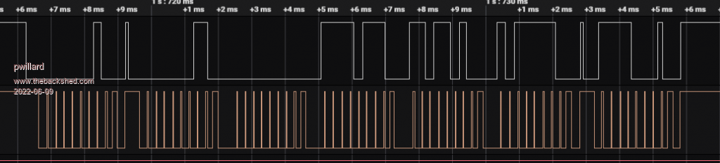

Ok, so I'm a noob.  But so far, my experience with the picomite (over serial until I get some additional parts) has been great.
1) I never hated basic
2) I got my first "boot to basic" computer back in 1982
2) This has been a very nostalgic experience so far.
My 80's era home computer could only wish to do what my Pico can do... so I've been giving myself challenges.
My latest challenge is to get this to work: TM1637
It's a bit tricky since it's basically a shift register (but not actually SPI) since it combines MISO and MOSI into a single bi-directional pin. It sends an ACK after 8 bits of sent data from the MCU. So, direction switching is needed.  I have the beginnings of the code done...  but the PICO seems up to the task of doing this handshake very "manually".
Anyway... off to the workbench to experiment some more.

Haha...  Now, why didn't I find that?
And it's cool that my write-byte code is similar, so I'm on the right track.
That datasheet is bloody awful.
Much thanks
Follow-up:
Using the example code provided, with some quick edits and a couple of added 'pause 0.01' commands... I got it working on my Pico.  It was kind of gibberish until I added delays near the clock pulses.
You saved me a ton of experimenting and it's appreciated.

@ DaveJacko,  did you get this code to work, I'm connecting and getting the time but the display is blank.
@ pwillard    any ideas
DaveJacko
Joined: 25/07/2019
Posts: 106
Posted: 09:01pm 22 May 2024
No joy
I have my own code that ** worked 100% on the Micromite, **
but produces largely random segments on the Pico.
I found that adding 5k pullups maybe improves things a bit.
althought there are 10k's on module
I'm going to add delays after every pin-change,
maybe try lower cpuspeed
here's the code..
