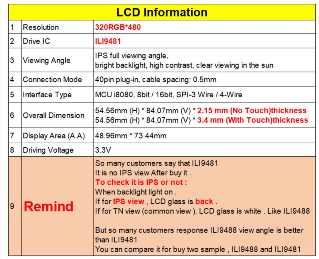

I bought a few different tft display modules to test on my PicoMite one of which is an ILI9481 which I found out was an IPS display and not TFT.
The first inkling I had was when the backlight didn’t seem to work (like the ILI9488) I then re-read the description and discovered it was an IPS type.
Is this usable on the PicoMite? I see some other display types that are IPS types in the manual but no mention on the ILI9481 IPS.

The display’s PCB looks identical to the ILI9488 board at least from the visible Rear side.
The description states SPI 3/4 wire ( see the table)
The ILI9488 that works fine states it is SPI 4 wire so there may be a difference there.
If you are interested this is the link of the ILI9481 I bought.

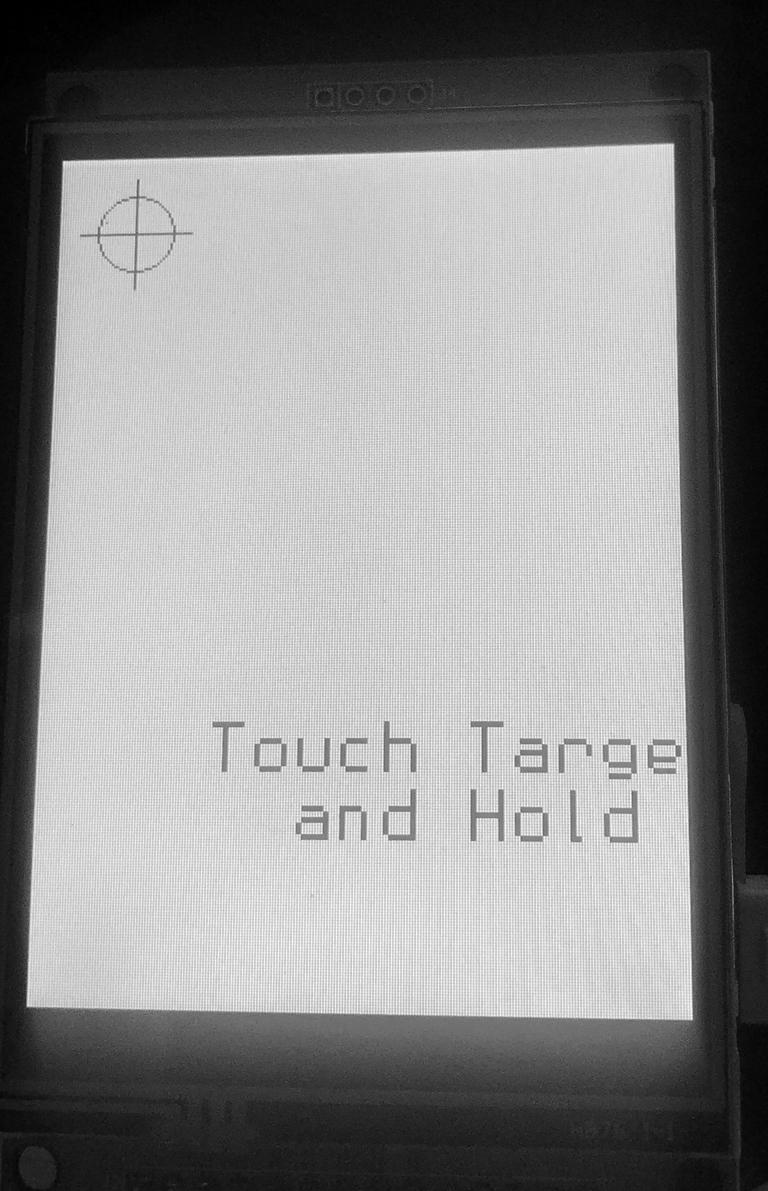

Hi All,
Progress is being made.
@PeterM,
Using the ILI9488 setting string below gave some promising but not perfect results
OPTION LCDPANEL ILI9488, PORTRAIT,GP15,GP14,GP13,GP20
The screen goes full white (And changes intensity as it should with the BL commands) which is the first time I have ever seen it more than a black screen
I tried a GUI CALIBRATE and the first point is displayed
Every other calibration point is off the screen and looks exactly the same, I press where the points should have been and they pass OK.
I notice the IMAGE is in NEGATIVE format, ie. what should be black is white and vice-versa.
Also it appears that the driver thinks the screen is twice the size (in resolution) than it is HENCE the text and targets being off screen.

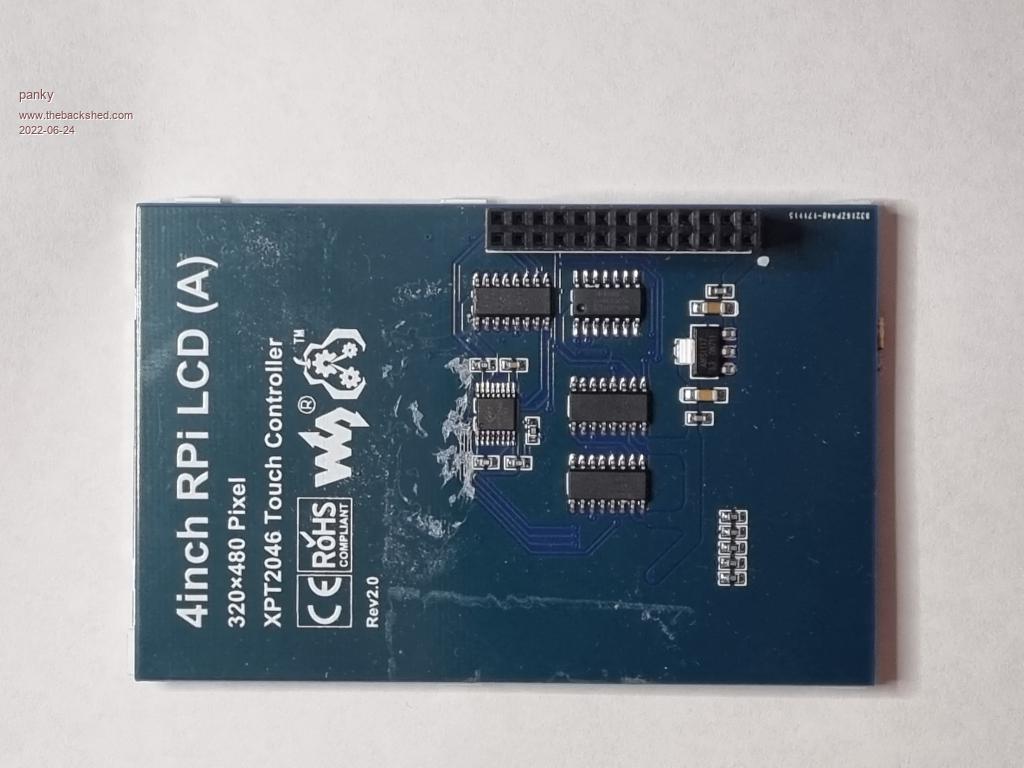

Mick,
Can you post a picture of the rear of the display. I have both 3.5" and 4" RPi connector style LCDs working fine using the ILI9481 option on the Pico however I don't think either are IPS style as they come up black screen after briefly flashing white on power up. I just tie the BL to 3V3 via a 68ohm resistor - have not got around to attempting BL control.
Doug.
PS. Mine have 2 74HC4094 chips, a 74HC04 and a 74HC4040.

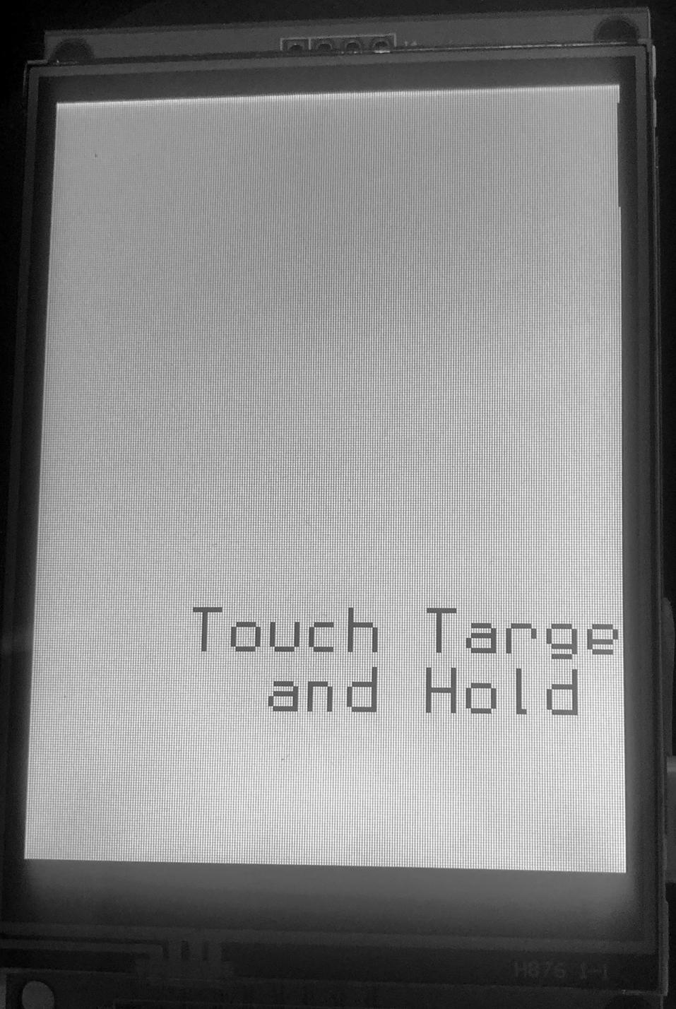

Hi All,
Further testing shows the screen fills with a box 241x321 in size as opposed to what it should be of 320x480
Also as I suspected the image is in NEGATIVE view
box 0,0,240,320,50,rgb(cyan)  GIVES a RED box
box 0,0,240,320,50,rgb(red)  Gives a CYAN box
The above give the EXACT screen width if I set 0,0,239,319 I have one pixel not filled at the RHS and at the bottom , if I set 1,1,240,320 I have one pixel on the LHS and TOP
I hope this helps in some way.
This screen will still be usable knowing all of the above but it will take some effort to work around in its current state
I believe this screen would be absolutely excellent for outdoor use as it is very bright compared to the IL9488 display.

Joined: 02/10/2012
Posts: 1135
Posted: 12:06am 24 Jun 2022
Mine all appear to have the shift registers.
Doug.
Posts: 2981
Posted: 12:46am 24 Jun 2022
HI ALL,
BIGMIK is an IDIOT
I did the above tests with an ILI9341 display NOT the ILI9481
The ILI9481 still shows a blank screen no matter what driver I install.
So sorry for leading you all astray.
As to the brightness the ILI9341 showed up about 3 times the brightness of the ILI9488 so I thought it was the IPS display.
Argghh! Sorry fellas

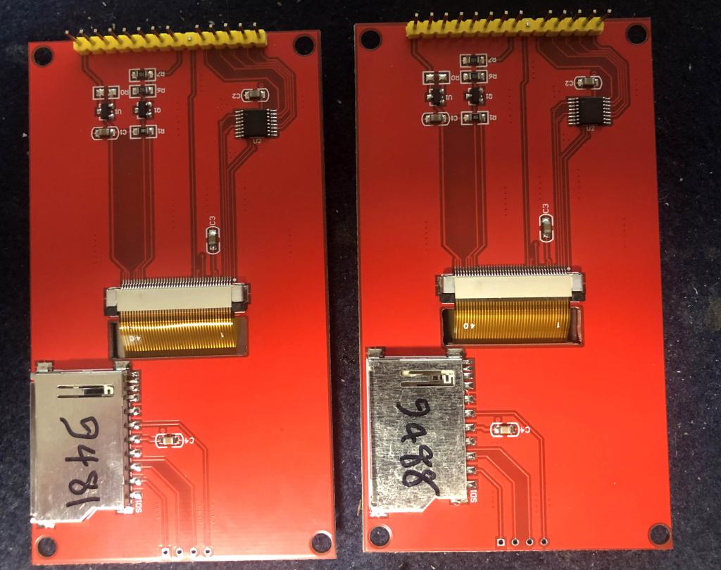

Posts: 2981
Posted: 12:52am 24 Jun 2022
Hi Panky, All,
My ILI9481 (on the Left) and ILI9488 (on the Right)
As far as I can see the PCBs are identical.
