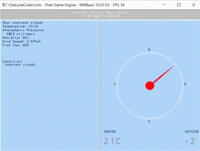

From the work of Lew247, matherp, and others.
In the lower right, outside and inside temperatures are hard coded, since no pins for connecting DS18B20s with MMBasic for Windows. At one time I had a web page set up on another device which had those readings, and another version of this program (F4, I think) got them--but I've lost track of that, so in this example they're unchanging awaiting revision (though I could just plug in the openweathermap.org temperature for "outside").
The code (MYID$ and APIKEY$ values need to be replaced for your locale)

Some detritus remains in the code from other versions using ESP-01. This data from weathermap.org doesn't return the weather icon code, so the icon is not displayed (icon bmp attached).

Posted: 03:10pm 17 Jul 2022
Hmmm, somehow an extra character got in the code when I copied it. the "x" before the single quote in line 9 needs to be removed.
Also, I noticed that the program was taking 40% to 50% of the CPU time. I put a PAUSE 950 just before LOOP in the main do loop, and that knocked it down below 10%. No point in spinning wheels while idling.
openweathermap.org has a restriction of no more than one call every 10 minutes, so I only update every 15 minutes, but the time updates every second. If you only wanted the time to show minutes, you could put in PAUSE 59950.
