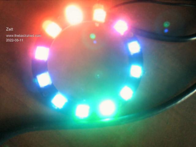

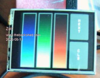

Hi ppl!,
I made some code to control a ws2812 leds(12ps)
Dim b%(11)=(0,0,0,0,0,0,0,0,0,0,0,0)
SetPin gp4,dout
Bitbang ws2812 o,gp4,12, b%()
Backlight 100
Colour &Hffffff,&H000000
CLS
groen=&h000000
rood=&H000000
For e=0 To 239
Line 10,e,70,e,1,e
groen=groen+&H000100
Line 80,e,140,e,1,groen
rood=rood+&h010000
Line 150,e,210,e,1,rood
Next e
uitlezen:
x=Touch(x)
y=Touch(y)
If x<0 Or y<0 Then GoTo uitlezen
If y<15 Then y=0
If x>10 And x<70 Then ledblauw=y
If x>80 And x<140 Then ledgroen=y*&H010000
If x>150 And x<210 Then ledrood=y*&H000100
ledkleur=ledblauw+ledgroen+ledrood
Bitbang ws2812 o,gp4,1,ledkleur
But when i change that number in the last bitbang it will not work. is there a good way to use var. and adress all leds on there own?

If you have 12 leds, you must always send data for 12 leds.i.e.the whole array.
To change an individual led, just alter its colour in the array and leave the rest of the array unchanged.e.g.
DO
'Bitbang ws2812 o,gp4,1,ledkleur
b%(0)=ledkleur
LOOP
Edited 2022-08-09 20:48 by disco4now

Posted: 11:08am 09 Aug 2022
offcourse. thx dude! i now got 12 leds i can adjust the color of. from a touch schreen written in basic! this is a happy day!
now i gona make a led clock with these ws2812!

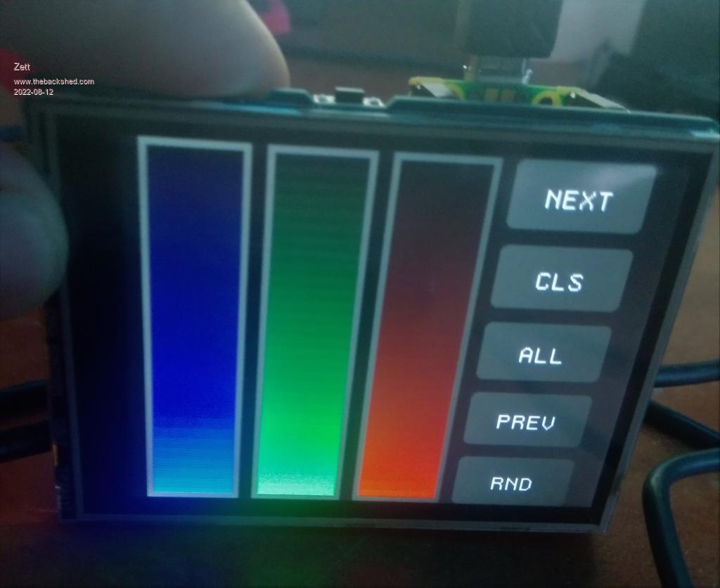

Posted: 11:25am 09 Aug 2022
The code:
SetPin gp4,dout
lednr=0
Backlight 100
CLS
groen=&h000000
rood=&H000000
For e=0 To 239
Line 10,e,70,e,1,e
rood=rood+&h010000
Next e
uitlezen:
x=Touch(x)
y=Touch(y)
If y<15 Then y=0
If x>220 And x<319 Then GoTo volgende
uit:
b%(lednr)=ledkleur
Pause 100
volgende:
lednr=lednr+1
If lednr>11 Then lednr=0
ledkleur=b%(lednr)
ledblauw=0:ledgroen=0:ledrood=0
GoTo uit

now on to the time to var program. :)
got sec$=mid$(time$,7,2) and now make it in to 5 sec steps as a var%
Zett
Joined: 18/06/2022
Posts: 14
Posted: 07:11pm 09 Aug 2022
' clock
SetPin gp4,dout
CLS
sec=0
min=1
uur=9
wacht:
If Timer<5000 Then GoTo wacht
Timer =0
For e=0 To 11
 b%(e)=&H0
Next e
 sec=sec+1
  If sec>11 Then sec=0:minc=minc+1
  If minc=5 Then min=min+1
   If min>11 Then min=0:uur=uur+1
     If uur>11 Then uur=0
B%(sec)=&H010000
b%(min)=b%(min)+&H000100
b%(uur)=b%(uur)+&H000001
Clock on yt
Edited 2022-08-10 05:30 by Zett

Posted: 08:57am 11 Aug 2022
Updated version.
now it got a next led button and it flashes the led that is selected.
and a CLR button. so you can set it to black again fast.
' ws2812 led circle 12
' Zett Darkstone 2022
SetPin gp4,dout
lednr=0
Backlight 100
CLS
groen=&h000000
rood=&H000000
For e=0 To 239
 Line 10,e,70,e,1,e
 rood=rood+&h010000
Next e
rc=&H606050
RBox 220,0,80,115,4,rc,rc
RBox 220,125,80,115,4,rc,rc
Box 10,0,61,240,4,rc
Box 80,0,61,240,4,rc
Box 150,0,61,240,4,rc
Text 259,54,"NEXT",cmv,4,1,0,rc
Text 259,179,"CLS",cmv,4,1,0,rc
Text 260,55,"NEXT",cmv,4,1,&Hffffff,-1
Text 260,180,"CLS",cmv,4,1,&Hffffff,-1
uitlezen:
x=Touch(x)
y=Touch(y)
If y<10 Then y=0
If x>220 And x<319 And y<115 Then GoTo volgende
If x>220 And x<319 And y>125 Then b%(lednr)=&B000000
uit:
b%(lednr)=ledkleur
Pause 40
volgende:
lednr=lednr+1
ledkleur=b%(lednr)
B%(lednr)=&H111111
Bitbang ws2812 o,gp4,12,b%()
Pause 100
b%(lednr)=ledkleur
GoTo uit

Posted: 02:45pm 11 Aug 2022
other update with buttons:
-next
-cls
-all
-prev
-rnd
Option autorun on
SetPin gp4,dout
lednr=0
Backlight 100
CLS
groen=&h000000
rood=&H000000
For e=0 To 239
 Line 10,e,70,e,1,e
 rood=rood+&h010000
Next e
rc=&H606050
RBox 220,0,80,40,4,rc,rc
RBox 220,50,80,40,4,rc,rc
RBox 220,100,80,40,4,rc,rc
RBox 220,150,80,40,4,rc,rc
RBox 220,200,80,40,4,rc,rc
Text 260,23,"NEXT",cm,4,1,&Hffffff,-1
Text 260,73,"CLS",cm,4,1,&Hffffff,-1
Text 260,123,"ALL",cm,4,1,&Hffffff,-1
Text 260,173,"PREV",cm,4,1,&Hffffff,-1
Text 260,223,"RND",cm,4,1,&Hffffff,-1
uitlezen:
x=Touch(x)
y=Touch(y)
If y<10 Then y=0
If x>220 And x<319 And y<40 Then GoTo volgende
If x>220 And x<319 And y>50 And y<90 Then b%(lednr)=&B000000
If x>220 And x<319 And y>100 And y<140 Then GoTo alles
If x>220 And x<319 And y>150 And y<190 Then GoTo vorige
If x>220 And x<319 And y>200 And y<240 Then GoTo ran
b%(lednr)=ledkleur
uit:
Pause 40
volgende:
lednr=lednr+1
ledkleur=b%(lednr)
B%(lednr)=&H111111
Pause 100
b%(lednr)=ledkleur
GoTo uit
vorige:
lednr=lednr-1
If lednr<0 Then lednr=11
ledkleur=b%(lednr)
B%(lednr)=&H111111
Pause 100
b%(lednr)=ledkleur
GoTo uit
alles:
For e=0 To 11
b%(e)=ledkleur
Next e
GoTo uit
ran:
For e=0 To 11
b%(e)=Rnd(1)*&Hffffff
Next e
GoTo uit
