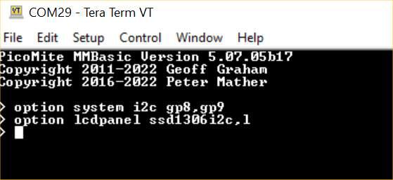

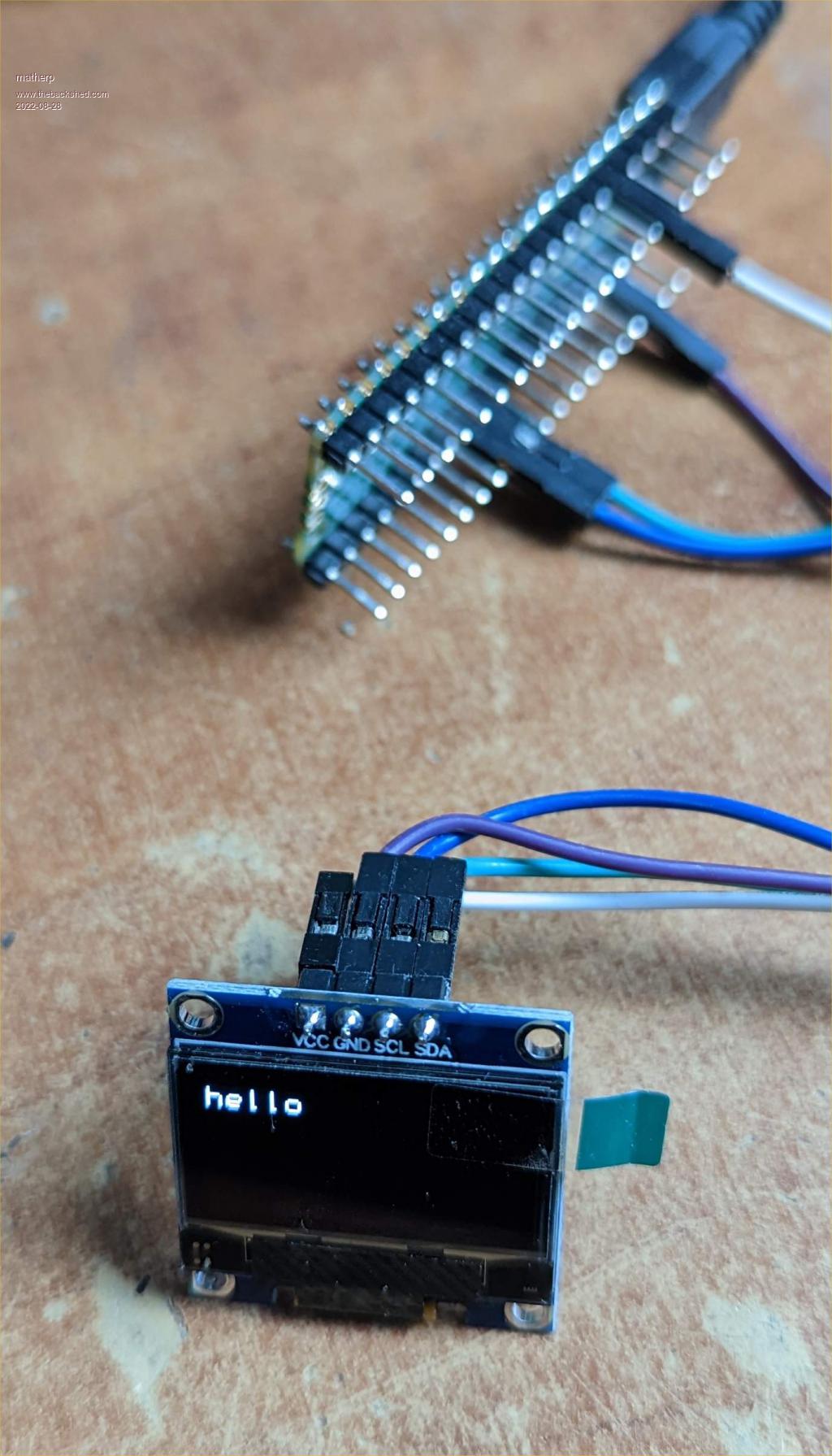

Is there a demo of ssd1306 working with i2c0 scl gp9 and i2c0 sda gp8 please?
I tried option lcdpanel ssdi306i2c, 1 and says invalid option.
I have not used i2c with mmbasic.

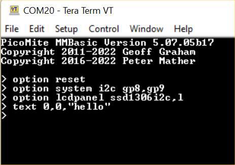

Start with OPTION RESET to clear anything there before. Then use the commands exactly as per my picture. You are using the PicoMite and not PicoMiteVGA firmware? 10K pullups will be fine but are probably already on the SSD1306 PCB
Edited 2022-08-27 07:46 by matherp

Posts: 2807
Posted: 10:39pm 26 Aug 2022
Thanks @matherp. using picomite non vga. I used ssd1306 on 8bit and 4k7 pullups.
option reset win disconnect reconnect sound.
> option reset
> option system i2c gp8,gp9
Error : Pin 11 is in use
rewired to gp6,gp7
> option reset
> option system i2c gp6, gp7 'gets this far ok
> option lcdpanel ssd1306i2c,l 'error
Error : Invalid Option
Posts: 3348
Posted: 11:07pm 26 Aug 2022
It has to be exactly as Peter showed.
You have this:
It should be this:
> option lcdpanel ssd1306i2c,1
l and 1 (L and One) look almost the same but MMBasic isn't interested in in looks!
Edit
Correction I was thinking of the offset.
OPTION LCDPANEL SSD1306I2C, OR [,offset]
try this (with the spaces, just in case they matter)
OPTION LCDPANEL SSD1306I2C, L ,1
Edited 2022-08-27 09:17 by phil99

Posts: 2807
Posted: 04:42pm 27 Aug 2022
it seems it is option lcdpanel ssd1306i2c,LANDSCAPE, 0
where the last ,0 it defaults to if omitted.

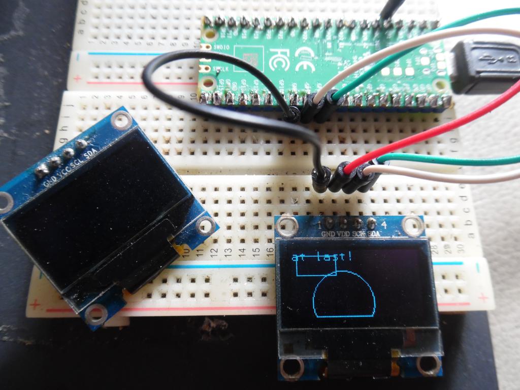

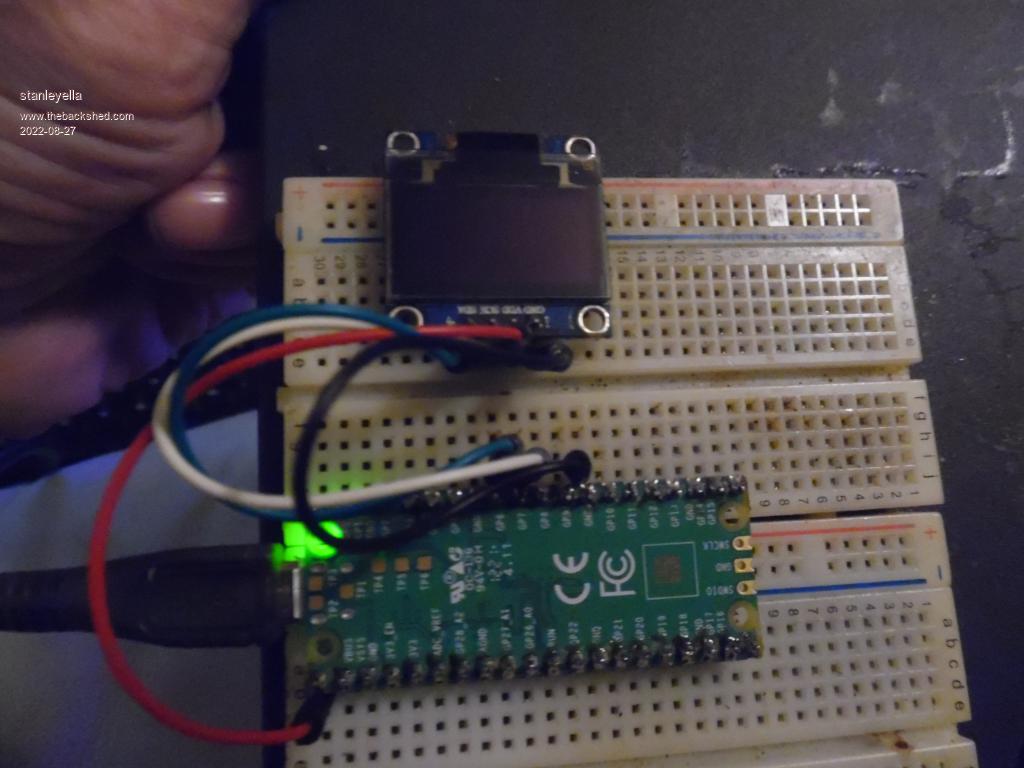

Connections:
SSD1306 VCC to PicoMite 3.3V
SSD1306 GND to PicoMite GND
SSD1306 SDA to PicoMite GP8
SSD1306 SCL to PicoMite GP9
No resistors needed just 4 link wires

Posts: 2807
Posted: 07:45pm 27 Aug 2022
what is not apparent is setting say touch and sd card and display but then using something new like a sdd1306 after using ili9341.
Start again and the reset from geoffs site
