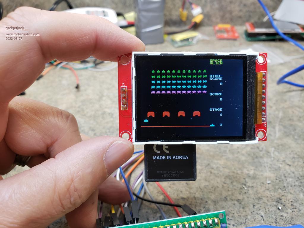

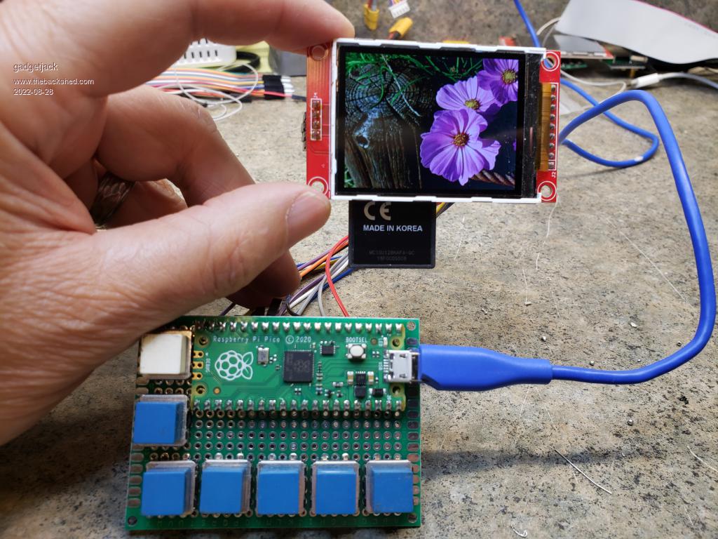

While surfing on github I found a new circuit for the Pico. A basic compiler with display and small keypad. I built it up this afternoon and it works pretty good. Very small list of parts and includes a few demos , games, and whatnot. Full source if your into the details , mostly greek to me so I just play with whats there.  it is at the following address  https://github.com/machikania/phyllosoma/releases. Get the zip file and everything is there. Not sure how to display pictures here but there are some in the file so you can see what it's about. Since we all have a lot of Pico boards , why not.          Jack.

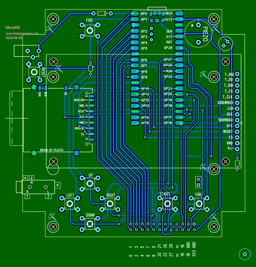

Some experimentation this morning led to this (incomplete):
It's based on the Hammond case PCB, but I don't think it will fit easily as the board will need to be on spacers and long buttons will be needed on the tactile switches. Something for the 3D printing people, I think. :) . It was just an experiment to see if I could get all the I/O. The sounder isn't connected yet.

Wow , I like it. Beats all the loose wires.......
