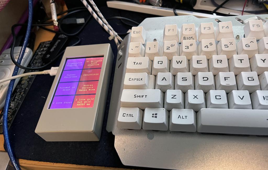

I read in the latest APC (Australian Personal Computer) Magazine an article for a `Rubber Ducky' that can emulate a keyboard. Sometimes these can be for criminal purposes to take control of a PC or, less nefariously, just be for adding keys/macros as a keyboard.
I have discussed this with my 'partner in crime' AndrewG and we have come up with the following code:

Now this sets up on a 480 x 320 display (the picture below shows an ILI9481 but an ILI9488 can also be used) as an extra/programmable keypad that sits nicely next to my keyboard.
I simply tap the key I want and it sends a string to a serial port.
Currently I am using the Console serial port but It ultimately will also work using the serial port (and a USB-TTL adapter) to feed strings into a USB (set as a COM port on the PC). This is not currently tested.
Now, I hear you all screaming that getting data into your PC's COM port wont work as a keyboard. Of course you are correct, however I found a neat little Utility called >>> DATASNIP <<< that is a `keyboard wedge' that redirects a COM port into the keyboard buffer.
Datasnip comes as a free to use "basic' version which does work however using the Serial Console at random intervals (usually 30seconds or so) an ESC sequence appears as key presses, [?25h   which I believe is a `Cursor ON' command and is part of the VT100 emulation of MMBasic Console. No other escape sequences appear.
The paid for version at $11AU inc GST or about $6US has some very nice features including a find string and replace it with something (or nothing). I wasn't able to actually get the [?25h  code to be captured but I was able to capture ?25h   ie. no [ character and replace with a backspace to delete the [.
OK, That is a bit of a PitA but in my application it hasn't been an issue for me.
If it was I would simply dedicate a USB-TTL adapter and use the pure COM port from the PicoMite which will have no VT100 emulations. Then the free version of Datasnip could be used.
As Datasnip (the paid version) has 2 programmable keys that can send a string out of the COM port I am currently working on adding a second page of buttons that can be toggled by a `hot' key.
Alright, I hear you saying there are many keyboard wedge programs out there BUT this has the advantage of showing what the key you press is without having to remember what hot key to use and what that hotkey is associated with.
Anyway, it is still a work in progress, Both Andrew and I hope that you will find some use or interest in this.
In my case it also got `rid of' an ILI9481 display that is much slower than the similar ILI9488.
Thank You AndrewG for creating the bulk of the code listed above. And apologies for my feeble additions.

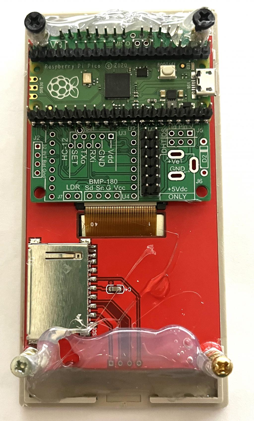

Here is a Picture of the Inside showing one of my PicoMuPs on the display.
The 4 screws are adjusted to hit the bottom of the case and absorb any heavy handed pressing of the touch screen the `hot snot' is simply to stop the screen moving vertically and horizontally.

Mick's photo above - ie the back of the LCD with the 'Hot Snot' - also shows Mick's PicoMup.
I'm not sure that he has 'released' it yet but one of these will form the basis of my Weather Station upgrade. It houses WiFi, DS18B20, HC-12, BM180, RTC and can connect to VGA or LCD, and breaks out all of the Pico's available data pins - plus more. All in a very small footprint.
