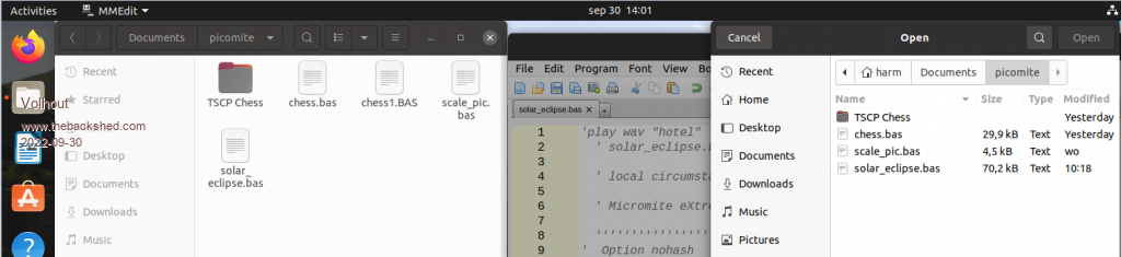

This is not the thread for MMEdit bugs, but there is one item (feature...not a bug) you might be able to fix fast.
On the linux version (linux distinguishes between lower case and captials).
If you try to open a program
You can open "xxx.bas"
But you cannot open (it does not even show in the browser) program "xxx.BAS".
Again, not a major issue....but a CAPITAL issue...

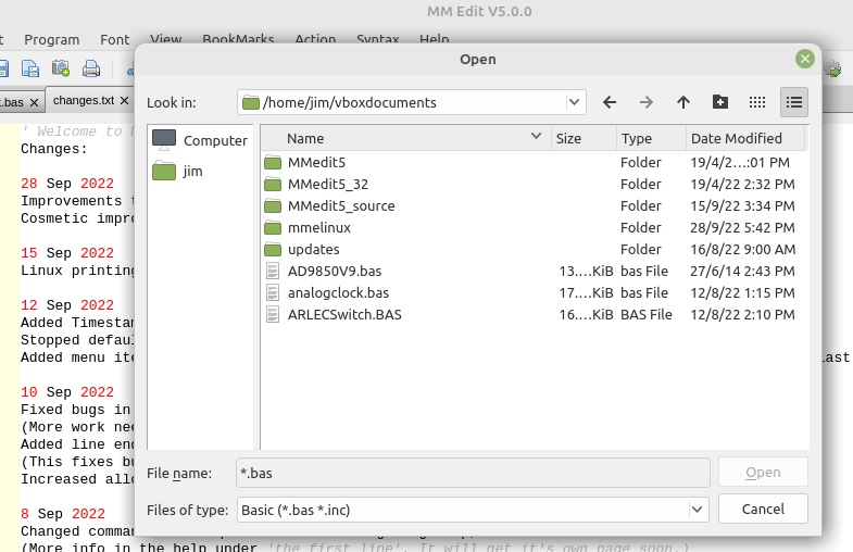

Posts: 6572
Posted: 07:57am 30 Sep 2022
Works OK for me.
Visible and loads OK.
What happens if you select "all files" as the file type?
I can add BAS and Bas to the list if needed.
Edited 2022-09-30 17:59 by TassyJim
Posts: 6035
Posted: 11:59am 30 Sep 2022
When I select "All" the file shows up.
When selecting "Basic" the file does not show (chess1.BAS in this case). This is MMEdit5 downloaded from your site last week. Running on Ubuntu 20.04. It is a fresh install (new Ubuntu 20.04.5, new QT5, new MMEdit, virgin machine).
Are you running in a virtual machine ? Is it possible you windows file system on disk (that mimicks a linux drive) does a translation ?
Edited 2022-09-30 22:07 by Volhout
Posts: 6572
Posted: 08:04pm 30 Sep 2022
  Volhout said  Are you running in a virtual machine ? Is it possible you windows file system on disk (that mimicks a linux drive) does a translation ?
Yes.
I did think of that.
I have also found that quite often there are glaring differences between the various Linux desktops.
Once the file is selected, the system does honor the case sensitivity.
I have decided that I will make it an option to start with *.* instead of *.bas with *.* as the default for Linux.
That keeps things simple and will cater for any differences between systems.
Edit:
My RPi also shows BAS as well as bas files so that's two Linux incarnations that don't restrict the file selector to specific case so the option to use *.* will be there but not the default.
You will have to edit the MMEdit5.inf to get the *.* starting position.
