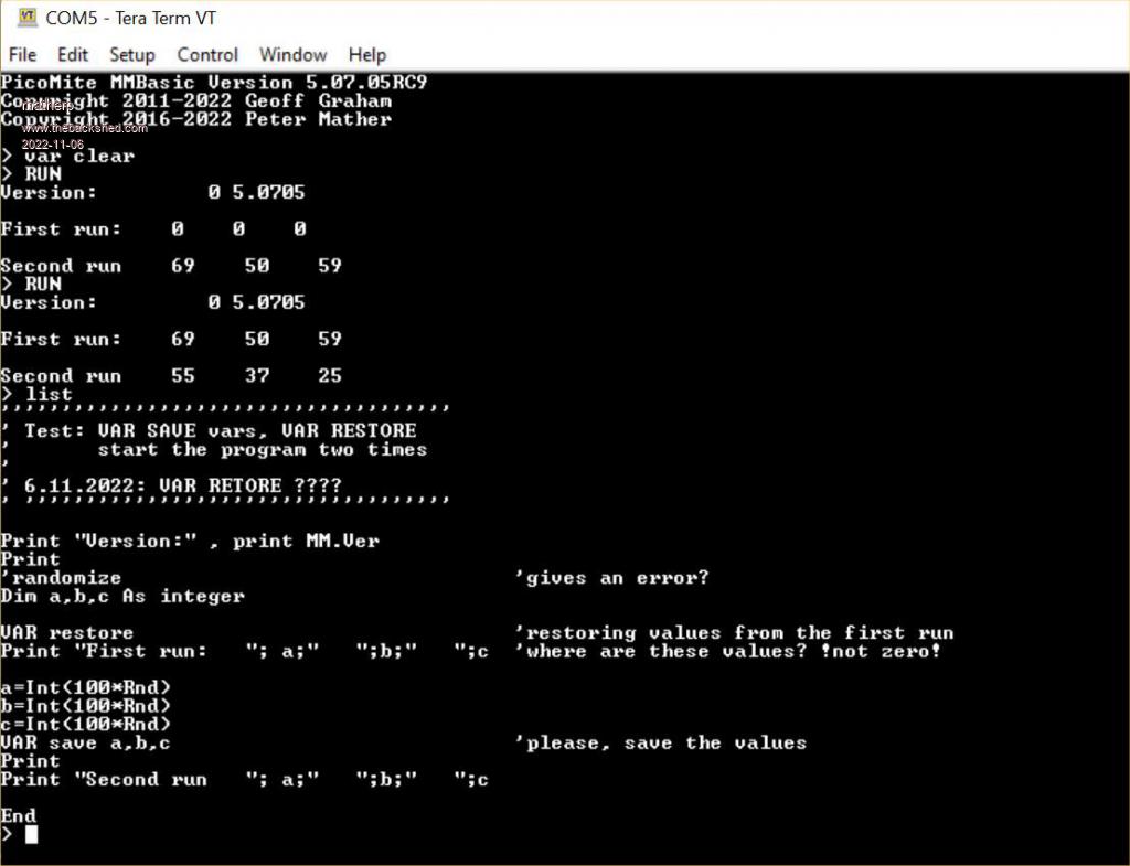

I have simplified the program. When I run it twice, the values from the first run are gone. I did not edit the program between the two runs. What happened?
' Test: VAR SAVE vars, VAR RESTORE
'       start the program two times
' 6.11.2022: VAR RETORE ????
print "Version:" , print mm.ver
print
'randomize                                'gives an error?
dim a,b,c as integer
var restore                               'restoring values from the first run
print "First run:   "; a;"   ";b;"   ";c  'where are these values? !not zero!
a=int(100*rnd)
b=int(100*rnd)
c=int(100*rnd)
var save a,b,c                            'please, save the values
print
print "Second run   "; a;"   ";b;"   ";c
end
Posts: 11744
Posted: 11:02am 06 Nov 2022
Don't know what you are doing wrong. Are you reloading the program between runs with MMEdit. Tested as below using Teraterm
rea23
Joined: 16/09/2022
Location: Switzerland
Posts: 26
Posted: 01:32pm 06 Nov 2022
It is a shame. You are absolutely right. It's obviously a bad habit of mine to press the rightmost icon in MMEdit, because it means exactly what it is, "load file and run it". Once again, it's a shame. Sorry for the time you spent.
Nevertheless, with the picture, you saved the situation for me. Thank you very much.
