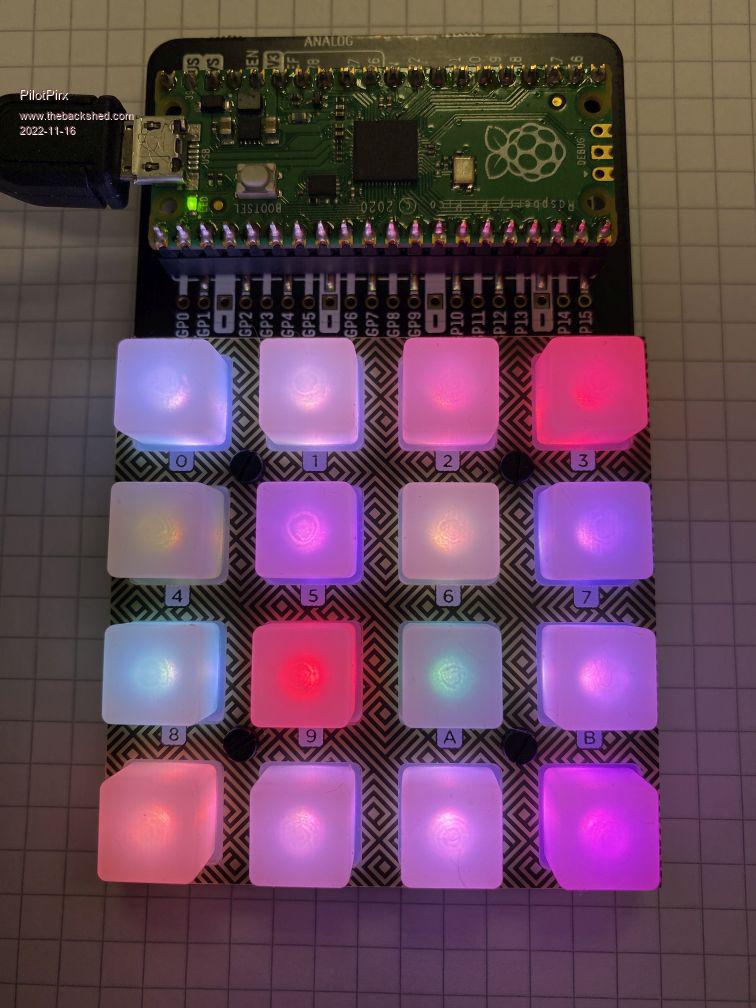

Hello,
I have written a MMBasic program to control the great RGB keypad from Pimoroni.
Feel free to improve and optimize it, because I am not an experienced MMBasic programmer. My knowledge is in C and Python. But it works fine so far.
Have fun with it,
Peter

Pin(17) never changes state?
PilotPirx
Joined: 03/11/2020
Posts: 138
Posted: 03:02pm 21 Nov 2022
Hello Tinine,
normally, on the SPI bus, the CS/Enable goes high after the communication is finished. But the APA102 has no CS. In this case, the CS only controls the buffer of CLK and MOSI. So you can also program as follows, but it makes no difference:
Pin(17)=1
End Sub
