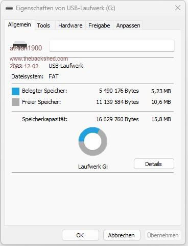

Posted: 03:11pm 01 Dec 2022
I successfully swapped the flash to a W25Q128.
What I can say is that the Mini Player behaves like a USB stick.
Windows formats the flash with FAT and then correctly shows 16 MB.
I copied a 5MB mp3 file and it works.
The copying process takes longer, since it is writing into the flash.
Next step a 25Q256 when these arrive
Posts: 10009
Posted: 12:10am 02 Dec 2022
Well done!
My modules have just arrived, but I am still playing about with the standard chip arrangement.  As I only ever wanted THESE modules for an annunciator project, having more then 4MB of storage is not an issue - for me.
But it is nice to see that you CAN swap the chip to get more space.
Please do keep us informed of what happens with the 256 chip.
I had visions of a couple of things with changing the flash memory chip, and they were: (1) The DY controller chip may not support anything other then 4MB, and (2) the flash memory chip may have to be factory-formatted, meaning you put a bigger blank one in there, and Windoze won't be able to format it, as the DY controller does not know how or have the ability to mimic to the OS how to format it kind of thing.
Glad to see neither of those turned out to be the case.
Good to know.
