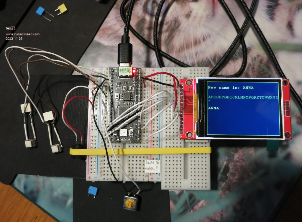

Hi
A short text, e.g. a name, is to be entered on a 2.4" display without touch screen. One possibility is shown in the listing. Maybe someone has a more elegant solution for this?
' INPUT a short text e.g. a name w/o KBD or Touch
' Use of three buttons: Left, Right and Enter
' Display 2.4", 320 x 240 ILI9341 (from MikroShop)
' works with ILI9488 driver only (Portrait mode)!
' Colors are inverted ! (255-RGB=iRGB) ?? cheap LCD
' MMBasic on Pi Pico with USB-C and on board RGB-LED!
' Test Buzzer: ok with SUB BUZZ
' 6.10.2022: Moving Cursor: two buttons < and >
' 09.11.2022: < / > button, 3rd button for Enter
' 10.11.2022: Display limit l/r ok
' Sometimes bouncing ===> 100 nF // to switches, ok
' New name: Move over margin </>, then Enter button
'OPTIONS:
'OPTION SYSTEM SPI GP18,GP19,GP16
'OPTION LCDPANEL ILI9488, P, GP15, GP14, GP13   !! false driver, but works
setpin GP23, dout                           'RGB-LED, on board
SETPIN GP3, dout                            'Buzzer
setpin GP4, intl, move_r, pullup            'Button >
setpin GP1, intl, move_l, pullup            'Button <
setpin GP2, intl, take, pullup              'Button Enter, pin4, GND: pin3
' !! inverted colors because of "false" driver for LCD!! Take RGB values

rea23
Joined: 16/09/2022
Location: Switzerland
Posts: 26
Posted: 01:15pm 28 Nov 2022
Thank you for the many good ideas and the shortening of the program. I have to think about what I want to use. But the idea to use a rotary encoder is really tempting.

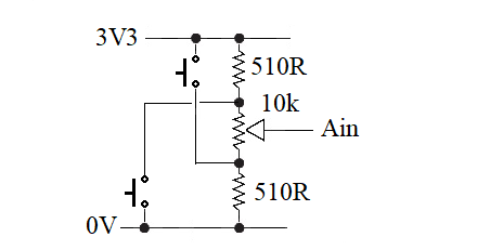

Posts: 3381
Posted: 08:36pm 28 Nov 2022
A button can be added to the pot. input without using an extra pin.
Add resistors (about 1/10th of pot. value) between the top and bottom ends of the pot. to the rails and put the button from wiper to ground. The bottom resistor ensures voltage can only reach zero when the button is pressed. The top resistor prevents a short if the button is pressed while the wiper is at the top.
A short press enters the letter and a long one enters the name, as in the above program.
Edit
Forget that.
Two buttons can be added to the pot. input without using any extra pins. Use the second to delete the last letter.
The top button inputs 3V3 and the lower 0V while the pot goes from 0.16V to 3.14V.

I made the circuit with a 10k potentiometer and R1k to 3.3 V and R1k to AGND. A button from wiper to ground is inserted. The setting of the letters works fine. But the transfer in the name always results in "?". Something in the program is terribly wrong and my old brain can't find the error.

Using Peter's insight and adding provision for a second button (top one in the above diagram) to delete the last letter.
It should work as you intend with your current wiring. The extra lines should not matter.

@matherp:
Yes, we have to define what happens if mvolt < 220 (switch down).
But if I insert a line "IF mvolt < 220 THEN letter=letter" at the end inside the loop, the same behavior can be seen.
@phil99:
