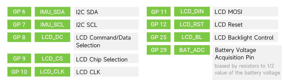

@Tinine - I tried to also select gp24 for MISO and I got back "pin in use"...
Not sure why... Did I miss something..??
option system spi gp10,gp24,gp11  right..??

  Zonker said  @Tinine - I tried to also select gp24 for MISO and I got back "pin in use"...
OPTION SYSTEM SPI
CLKpin, MOSIpin, MISOpin
All I can see is that you appear to have MOSI and MISO flipped(?)

Posted: 05:13pm 02 Jan 2023
Ok.. Tried option system spi gp10,gp11,gp24..  Same error, gp24 is in use..
The only one that seems to work is gp10,gp11,gp12... (that makes sense)...
But then the display wants to use gp12 for the display reset...
Says that gp12  is reserved on startup... (for system spi)...
I am running V5.07.06B7 of the firmware..
What does your setup look like..??
Posts: 11995
Posted: 05:29pm 02 Jan 2023
Start with OPTION RESET and then
OPTION SYSTEM SPI GP10,GP11,GP28
OPTION LCDPANEL GC9A01, LANDSCAPE,GP8,GP12,GP9,GP25
or
SETPIN GP24,OFF
OPTION SYSTEM SPI GP10,GP11,GP24

Posted: 11:37pm 02 Jan 2023
Thanks Peter... That did the trick...
I think the "pin24" had me confused and didn't know you had to turn it "off"
I also was doing the "option heartbeat off" command to free up the LCD backlight pin...
I ended up using your first example:
