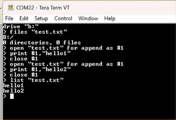

Are you setting the active drive to be the SDcard?
Drive "b:"
Kill "test.txt"
For i=1 To 10
Open "test.txt" For append As #1
Print #1,"hello "+Str$(i)
Close #1
Next
List "test.txt"
works perfectly for me on the SDcard. There does seem to be a bug on using append with the flash file system that I need to look at.
