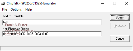

Hello to all,
now that we have such a great flash drive on the PicoMite, I tried a little something.
You can find the sampled allophones of SPO256 on the net:
https://www.cpcwiki.eu/imgs/5/52/Allophones.zip
https://www.cpcwiki.eu/index.php/SP0256_Allophones
I copied these once directly and once renamed (see: https://www.cpcwiki.eu/index.php/SP0256_Allophones) to the flash drive. (My renamed allophones are here:Allophones as HEX.zip)
Why the renaming? Then you can convert text to the appropriate phonemes very easily with this tool here (https://web.archive.org/web/20210211045521if_/http://www.speechchips.com/downloads/chiptalksetup.exe).
...I probably should have renamed the files to the format "0xXX" rather than "XXh" - I can still do that...
The program on the PicoMite for this is very simple:

Now you can call the phonemes either with the HEX designations or with the actual phoneme, as realized below.
Do not forget: The emulation sounds just as bad as the original!
Frank

Frank N. Furter
Joined: 28/05/2012
Posts: 1154
Posted: 07:38am 04 Jan 2023
@scruss:
It looks like the WAV were just hardcoded into "allophones.c". I don't think this does anything - except that it ALWAYS takes up space...
It would be more interesting to emulate the CTS256 - then you wouldn't have to search for the matching phonemes every time...
@Martin H.:
Yes, you need the files from the linked ZIP. It was not my idea - ChipTalk (from the above link) works in the same way.
Frank
