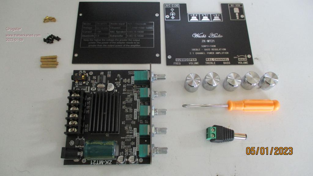

I got one of these from AliExpress during the Christmas holidays, and I am very impressed with it!
Link to amplifier...
This one has both a standard 3.5mm analog audio input socket, and also Bluetooth 5 wireless audio.
Considering it's absurdly cheap US$12 price, it works VERY well indeed.  With a 13.8v DC supply, it blows the room apart, with very nice control of both the sub volume AND the crossover frequency - a feature most 2.1 amps DON'T have, especially at this price point.
Comes as a sort-of knock-down kit, requiring some simple assembly, but you get all the bits including the knobs and even a DC-to-terminal adaptor thing for power supply and even a cheap screwdriver!  All this comes packed inside a nice cardboard box.
Audio is via 3.5mm plug or wireless BT5 connection, but NOT BOTH - one or the other.
Excellent insulated terminals for the speaker connections, and very cute panels with labelling etc on it.  Very impressive for twelve bucks!
Windoze sees it as a "Stereo headphones", with an ID of WUZHI, which matches the name of the amp itself, so finding it and connecting to it was dead easy - not always the case with cheap BT stuff out of China.
I don't know how much faith I would put in the 50W+50W+100W rating, but it sure has plenty of grunt for a set of modest PC speakers or perhaps for your gaming rig.

I think that this will ust about fit in that little Hammond 1593 case that I've been using. Might need a dremel to take the pcb supports off the top half.  :)
It's a rather nice looking little amp. Might have a radiated interference problem as it stands though. It'll be bridged class D but the speaker outputs appear to be unfiltered.

" It'll be bridged class D but the speaker outputs appear to be unfiltered."
If so connect the speakers with microphone cable. Shielded twisted pair.

... and instantly the hi-fi aficionados will throw up their hands in horror! :)
I see they also do a "hi-fi" version of the amp that includes output filters. Well, they refer to it in the ad, but there don't seem to be any.

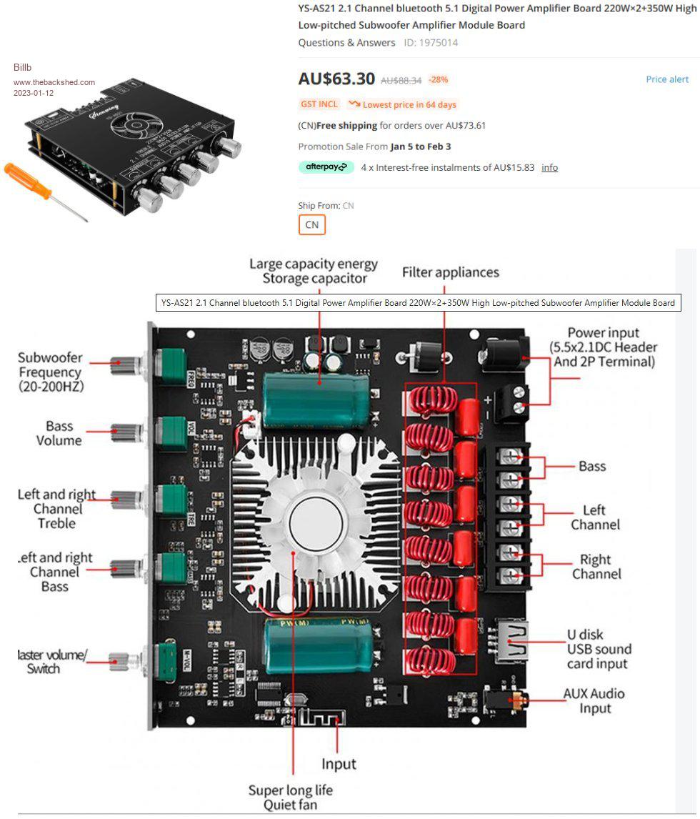

This model appears to have output filtering.

Nice find, Bill.
Thanks.

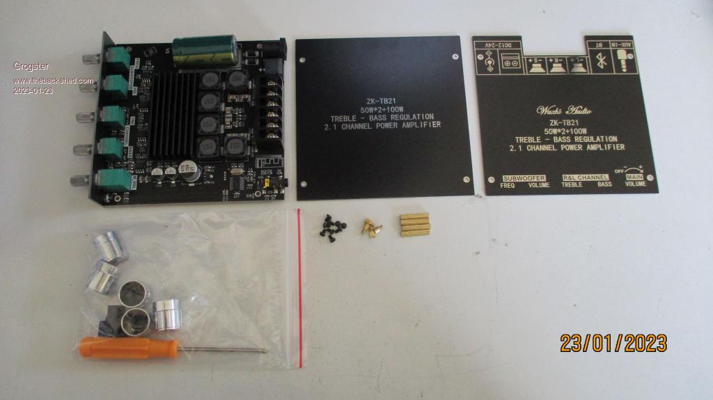

EDIT: Further searching revealed this amp with filters for NZ$25, so I think I will just get one of those as that one has the filters on-board also.  Same company, same features, same knob layout etc, just with the additional output filtering.

That's a beast! Cheap too. :)

The $12 one I have here now, kicks ass, BUT it HAS revealed some issues with the BT connection.
Once connected to some long-ish speaker leads, although it sounds fine, the BT keeps getting SERIOUSLY corrupted, and the audio sounds like it it underwater most of the time.
Connecting via a hardline 3.5mm lead totally fixes this problem, so perhaps we do indeed have an EMI radiation problem - the speaker leads acting as transmitting antennas to some extent, which then swamp the BT connection.
I have not yet found my EMI test probes, but that is what I am thinking.
But with the new version with built-in filtering, I am hoping that perhaps the BT connection will work better.  If not, I can still use the hardline AUX input.

I bet it's radiating like mad. A flourescent tube or a neon might light near the speaker leads. :)

You could always knock up a filter on some strip-board. If it won't fit inside just attach it to the terminals.
Posts: 9131
Posted: 11:53am 14 Jan 2023
Too easy, Phil. :)  Ferrite beads & little caps are all that's needed to get rid of AM band RFI according to the data sheet.
