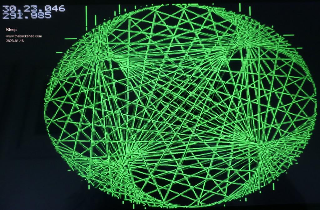

If I use Martins method of only clearing the circle, not a full CLS, if you run your AA version for a few minutes you get artefacts outside the circle, straight vertical or horizontal lines. Remove the AA option and you don't get these. This is on a VGA Picomite.
Regards, Kevin.

Posts: 12176
Posted: 10:32am 14 Jan 2023

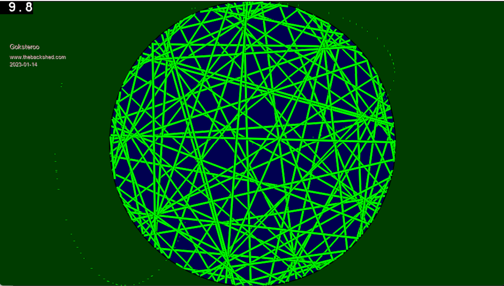

The AA line drawing algorithm doesn't terminate the lines in a way related to the angle but chooses a vertical or horizontal depending on the slope. See the pics here

Ok, but these are long lines, sometimes all the way to the screen edge.

Here is a pic to show the artifacts when using LINE AA  - at least with MMB4W. This is done with a line width of 4. Note there are also extra pixels within the circle as well.
Geoff

Posted: 03:31pm 15 Jan 2023
Hi Peter,
Thanks for the update with some Pixel drawing fixes, they don't seem to have cured my horizontal and vertical artefacts when using AA, see photo, if you run the code above they will start to appear within a minute or two, at least the do on my Pico.
Regards, Kevin.
