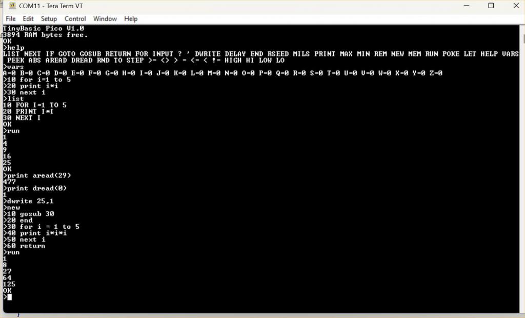

Posted: 11:37am 22 Jan 2023
Pico_TinyBasic.zip
Connects via USB

Ooh....  must play!
This one is very BASIC, isn't it?
There doesn't appear to be any strings and @() isn't implemented.
What is it based on?
Hurray for WHAT? HOW? SORRY!
I see it uses the first 2 characters of a command followed by a full stop. :)

This is tiny basic. 16 bit integers only, no float, no strings, only 26 variables. I modified it 5 years ago to run on a arduino uno.

I got the source from here
There was one major gotcha in running on the PICO. Line numbers are stored as 2 byte values and used in various ways. The Arduino source assumes you can use them as an index but 32 bit processor like the RP2040 can't cope when 2-byte or 4-byte values aren't aligned in memory and the TinyBasic source didn't force this so I had to.
Implemented in my version is:
Supported statements and functions
System
   BYE - exits Basic, soft reboot on Arduino
   END - stops execution from the program, also "STOP"
   MEM - displays memory usage statistics
   NEW - clears the current program
   RUN - executes the current program
File IO/SD Card
Not implmented
EEProm - nonvolatile on-chip storage
Not implemented
IO, Documentation
   INPUT variable - let the user input an expression (number or variable name
   PEEK( address ) - get a value in memory
   PRINT expression - print out the expression, also "?"
   REM stuff - remark/comment, also "'"
   POKE not implemented
Expressions, Math
   A=V, LET A=V - assign value to a variable
   +, -, *, / - Math
   <,<=,=,<>,!=,>=,> - Comparisons
   ABS( expression ) - returns the absolute value of the expression
   RSEED( v ) - sets the random seed to v
   RND( m ) - returns a random number from 0 to m
Control
   IF expression statement - perform statement if expression is true
   FOR variable = start TO end - start for block
   FOR variable = start TO end STEP value - start for block with step
   NEXT variable - end of for block
   GOTO linenumber - continue execution at this line number
   GOSUB linenumber - call a subroutine at this line number
   RETURN - return from a subroutine
Pin IO
   DELAY timems*- wait (in milliseconds)*
   DWRITE pin,value - set pin with a value (HIGH,HI,LOW,LO)
   DREAD( pin ) - get the value of the pin
   AREAD( analogPin ) - get the value of the analog pin
   AWRITE not implemented
