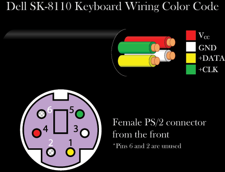

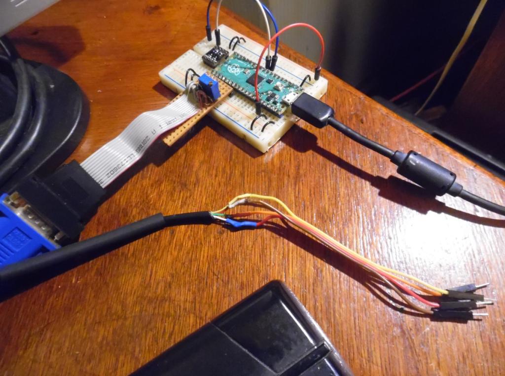

vga mini ps2 plug keyboard.
The manual shows front view but I cut the lead and buzzed the connections and it's
green....O || O
yellow..O      O..red
white.....O  O
so it's the ps2 mini socket front view,not the keyboard plug?
Don't open the keyboard to see the wiring, it'll never work again,they are so cheaply made.
Posts: 7877
Posted: 04:50pm 08 Feb 2023
It's no good going off the colours. They aren't guaranteed to be the same for all manufacturers (or for all keyboards of the same model from the same manufacturere for that matter!). It's pin numbers that are important.

True Mick and I am colour blind but red/green so coloured wires not a large area to see. I got an inverter circuit set up but kb wires?

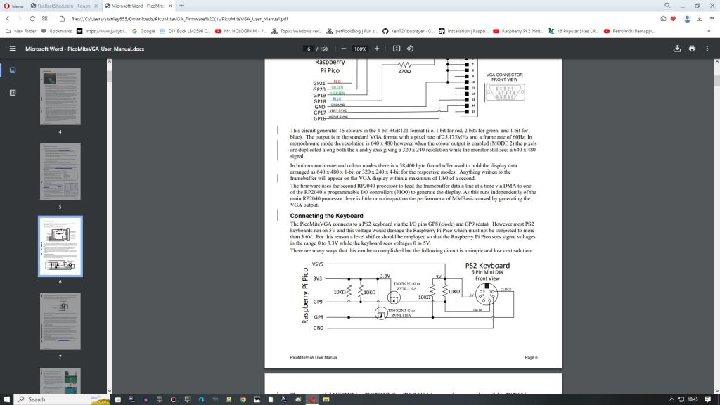

Posts: 2619
Posted: 09:57pm 08 Feb 2023
Latest PicoVGA manual page 6 bottom.
Clock...green....O || O
Gnd.....yellow..O      O..red...5V
Data....white.....O  O
Posts: 2547
Posted: 06:42pm 09 Feb 2023
Hi Phil, my keyboard is now working, UK keys.
I'm very happy, vga and keyboard. Many thing to explore.
page 6 in my manual shows reverse view from kb plug. It does say keyboard front view but it's not.

Posts: 2547
Posted: 09:08pm 09 Feb 2023
I was impressed when the keyboard worked.The £1 level converter worked fine, lot less bother than the converter in the manual.

Posts: 2619
Posted: 09:27pm 09 Feb 2023
The circuit shown is wiring up a socket, viewed from the front of the socket and is correct. The view from the front of a plug is the mirror image.
You are not the first to be caught by this. A very expensive instance was when a 3 phase generator was being wired in to the local fire station. The electrician wired the inlet socket the same as an outlet socket. All the roller doors turned backwards and were severely damaged.
