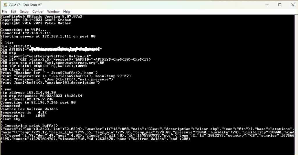

For those not following the other thread, I have ported the PicoMite firmware to the Pico W
This variant has all of the functionality of the standard PicoMite with the exception of the GUI commands and function. These have made way for the WEB command that allows wireless access to the internet and the json function has also been added to allow you to parse the data from things like openweathermap.org.
No extra hardware is needed to work as a web server and/or web client.
The latest alpha release is V5.07.07a3
PicoMiteWeb.zip
The code is still alpha so expects lockups and resets and make sure you back up programs to the flash disk, flash slots, or an SDcard (NTP seems to be a particular culprit for lockups). Alternatively do your development in MMEDIT and that way you will never lose anything.
To install the firmware just copy the uf2 file to a Pico W in boot mode as normal.

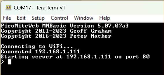

To connect to your WiFi router use the command
OPTION WIFI ssid$, password$
e.g. OPTION WIFI "myssid","myduffpassword"
The Pico will reboot and you should see it report connection and its IP address.
You can now use a range of commands to access the network

Again the Pico W will reboot and will report both the connection to the WiFi router and that a TCP server is now running

Today's new functionality supports TCP client mode.
This allows you do talk to a TCP server (obviously   )
The command
WEB OPEN TCP CLIENT address$, port
opens the client and connects to the web address specified. The web address can either be a URL e.g. "api.openweathermap.org" or an IP address e.g. "192.168.1.111"
Then we can use the command
WEB TCP CLIENT REQUEST request$, buff%() [,timeout]
to send a request to the remote server and wait for an answer. The optional timeout parameter is in milli-seconds and defaults to 5000.  buff%() is an integer array which will receive the response as a LONGSTRING
e.g.
WEB TCP CLIENT REQUEST "GET /data/2.5/weather?q=Saffron Walden,uk&APPID=xxxxxxxxxxxxxxxxx"+chr$(10)+chr$(13)
If the request times out you will get an error. Otherwise the received data is in the LONGSTRING
If the received data is a json string then you can use the JSON$ function to parse it
JSON$(array%(),string$)
Returns a string representing a specific item out of the JSON input stored in the longstring array%()
e.g.
JSON$(a%(), “name”)
JSON$(a%(), “coord.lat”)
JSON$(a%(), “weather[0].description”)
JSON$(a%(),”list[4].weather[0].description
Examples taken from api.openweathermap.org
Having received data from the client it is normally the case that you want to close the client connection using
WEB CLOSE TCP CLIENT
At the moment only one client connection is allowed
A full example application is given below - pretty simple. Note if you have used openweathermap before they have changed the interface and you may need to sign up for a new (free) account to get your APPID .
Dim buff%(512)
Dim APIKEY$="xxxxxxxxxxxxxxxxxxxxxxxxxxxxxxxxx"
WEB ntp
Dim report$="weather?q=Saffron Walden,uk"
Dim b$= "GET /data/2.5/"+report$+"&APPID="+APIKEY$+Chr$(10)+Chr$(13)
WEB open tcp client "api.openweathermap.org",80
WEB TCP CLIENT REQUEST b$,buff%(),10000
WEB close tcp client
Print "Weather for " + Json$(buff%(),"name")
Print "Temperature is ",Val(Json$(buff%(),"main.temp"))-273
Print "Pressure is ",Json$(buff%(),"main.pressure")
Print Json$(buff%(),"weather[0].description")

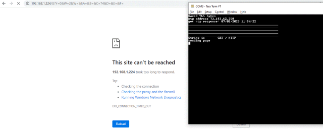

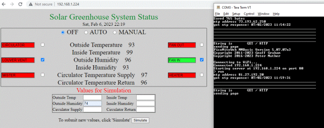

With a structure like the following, why am I getting a timeout?
initial:
 Dim buff%(512)
 WEB ntp -5
 initialize
main:
 do
   watchdog 60000 ' lb if not executed in 60 seconds, restart
   if sMinuteDigit <> mid$(time$,5,1) then newMinute
   if SIMULATE then poll
'    GetUserInputs  ' get inputs from local display
'    ReadSensors    ' get temperature and humidity
'    DisplayData
 loop
Sub poll
Local p%, t%, ii%, ss$
For ii%=1 To mm.info(max connections)
  LongString clear buff%()
  WEB tcp read ii%,buff%()
  p%=LInStr(buff%(),"GET")
  t%=LInStr(buff%(),"HTTP")
  If LLen(buff%()) Then Print "_________________________________________________"
  ss$=""
  If (p%<>0) And  (t%<>0) And (t%>p%) Then
    ss$=LGetStr$(buff%(),p%,t%-p%+4)
    Print "String is ",ss$
  EndIf
  If Instr(ss$,"small") Then
    Print "sending picture"
    WEB Transmit FILE ii%,"small.jpg","image/jpeg"
  ElseIf Instr(ss$,"favicon") Then
    Print "sending icon"
    WEB Transmit FILE ii%,"favicon.ico","image/vnd.microsoft.icon"
  ElseIf Instr(ss$,"HTTP") Then
    Print "sending page"
    WEB transmit page ii%,"gh.html" ' "gh.html"
  EndIf
Next ii%
End Sub

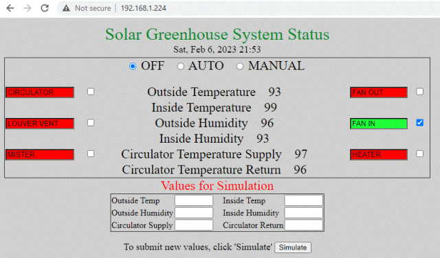

After some initialization, my main loop calls "poll". That successfully sends my page when I make the request in the browser. When I enter data and press the <Submit> button, my GET request is shown with "Print "String is ...". Then after a minute it times out. I had assumed that it would quickly do the 4 loops in "poll" and return to the main loop with the WATCHDOG 60000 statement.
What am I doing wrong with this structure?

Making some progress:
I'm not getting values returned when I check a box and enter a value and press [Simulate].  After a minute, I get a watchdog timeout. Some minutes later I get this on the browser line: http://192.168.1.224/G?Y=0&W=2&W=5&A=&B=&C=74&D=&E=&F=
(Which is expected.)
I'll try again removing the watchdog command.

poll must be called repeatedly and should not be contingent on anything. It is completely benign if no communication has occurred

I'm still stuck. I changed the original webserver.bas program to serve my html page, gh1.html:
Dim buff%(512)
Dim myfloat!=16.123
Dim myint%=999
Dim mystring$="The PicoMite Web is GO!!!"
WEB ntp -5
poll
Sub poll
Local p%, t%
For a%=1 To MM.Info(max connections)
WEB tcp read a%,buff%()

The page is served fine:
If I click the "LOUVER VENT" checkbox, put "74" in the "Outside Humidity" box, and press "Simulate", nothing happens for some time and then I get this:
There's never a response from the server, and MMBasic is locked up--I have to power cycle to get the ">" prompt. (In fact, the server is locked up immediately after it prints "sending page".)
Attached is the html file, "g1html.zip"--it contains gh1.html.
Any thoughts on what I should do?

  Quote  Attached is the html file, "g1html.zip"--it contains gh1.html.
I can't see the attachment.
What browser are you using?
If you print out the full packet sent by your broqwser, it migh thelp see what's happening.
   longstring print buff%()' add this line.
