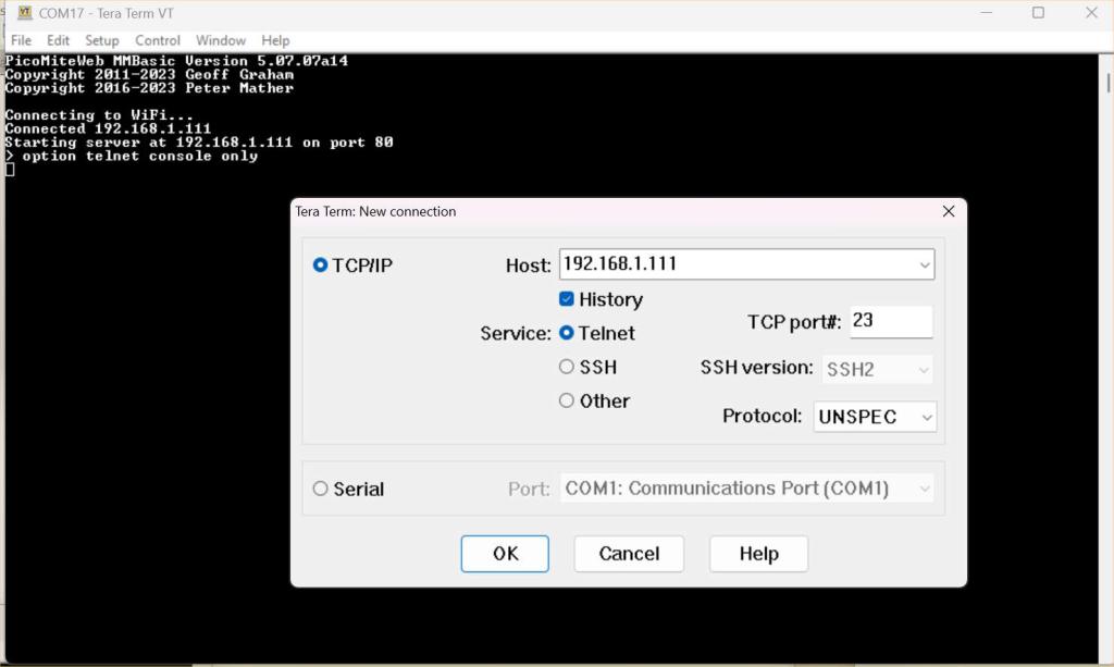

OPTION TELNET CONSOLE ON/OFF/ONLY
When set to ON or ONLY you can Telnet to the PicoMiteWEeb on port 23. You are still able to set up and run an HTTP server on port 80 (OPTION TCP SERVER PORT 80)
If set to ON console I/O will be available on either the USB port, the serial port or both as well as via Telnet.
If set to ONLY then the Telnet connection will be the only console port
Also in this release the number of connections is increased to 8 (untested)
The Telnet console is OK although you will see slight hesitation in single character echo (there is a lot going on to transfer 1 character). Transfer of multiple characters in the editor or the LIST command is very fast.
Don't ask how to configure Telnet on Linux/Mac etc. I don't know (or care?). It works well with teraterm on windows

  matherp said  V5.07.07a14
What is your TeraTerm configuration? I don't get the commands displayed, but only after the Enter key. If I turn on the local echo, the command comes as output only after the Enter key.
An EDIT calls the editor, but ESC does not terminate it. The other keys F1, F2, ... do not work either :-(
All console commands work so far, with the above limitations.
Putty helps only conditionally. There I get a ^C to exit the program after a RUN. Enter then helps and I am back in the console.
Somehow I can't find the right TeraTerm setting to use the editor. Does anyone here know the correct settings and can help me?

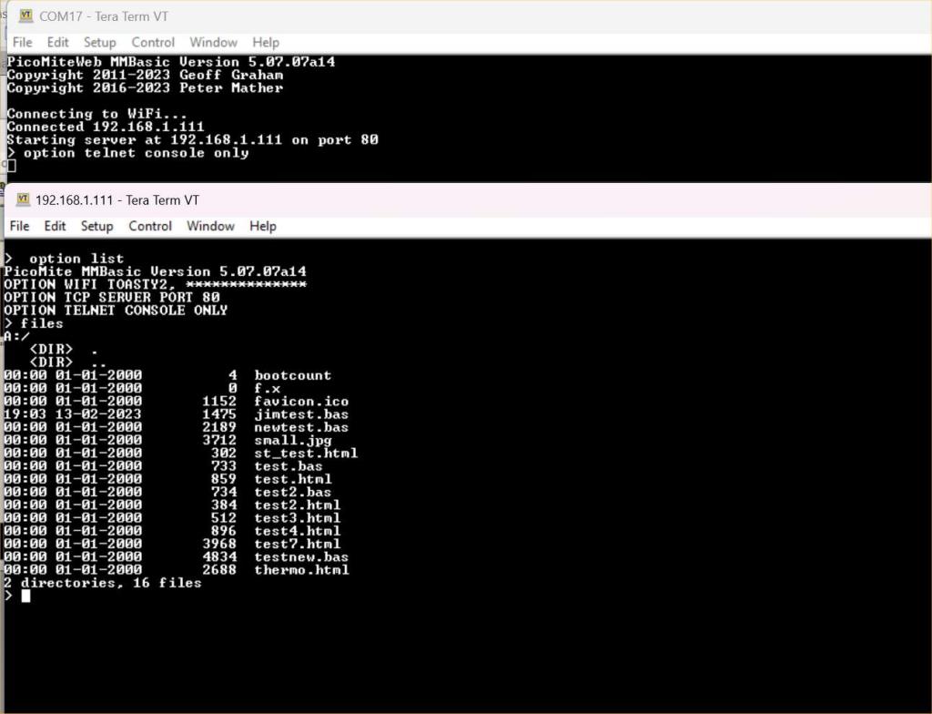

One more version
PicoMiteWebV5.07.07a15.zip
Autosave now works over Telnet- use an inter-line wait of 20mSec
Teraterm/Setup/Additional settings/Copy and Paste/Paste delay per line
XMODEM works over telnet BUT.....
It can only support up to 254 blocks of 128 characters
It will fail in either direction if the checksum works out to be 255 (-1)
It doesn't appear I can do anything about this unless I can get TCP to run in raw mode.
Supported speeds for PicoMiteWeb are 64MHz to 264MHz. I find 256MHz completely reliable
  Quote  Are they something we can delete?
Yes, of course. Just connect to the address of your Pico
