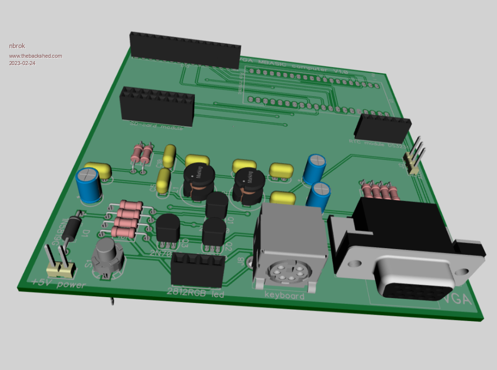

Hi,
This will become my vgapico board. Dimensions are 100 by 100mm.

Nice to see another 100mm x 100mm board fan. :)
I would advise that you take some sort of feet into consideration. A lot of us have work benches with bits of junk on them and it's nice if the bottom of the PCB doesn't get shorted out. :) Some 3mm holes would allow for some short mounting pillars to be used. Your decision though, not mine. :)

Hi Nick,
Am I mistaking or is there no audio output ??

  LucV said  Hi Nick,
Luc
On the right is the audio output.. and I forgot the screw holes... thanks..
