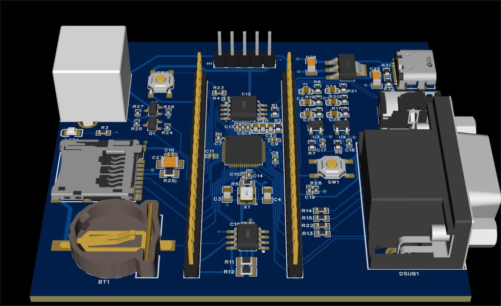

Here is the EasyEDA version of the schematic
SCH_Schematic1_2023-03-18.pdf
And this is the PCB. All of this was created in a single day completely manually (no import of the DesignSpark files possible).
Overall, I'm impressed and can highly recommend EasyEDA for anyone who wants to get into PCB design.

That looks like a very good system! The schematic alone is a huge improvement.

The schematic looks very clear - but I was surprised that not everything is as searchable as I expected, e.g. both GP29s are found but both GP19s (& others) are not.  Might be something I'm doing wrong?
The 3-D board view is great!

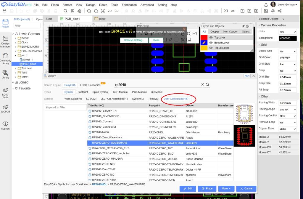

lew247
Joined: 23/12/2015
Posts: 1709
Posted: 02:16pm 18 Mar 2023
I've been using it for a few years now
You can make your own components if they aren't included
but I find the under search for a component "User Contributed" section it almost usually has anything required
pwillard
Joined: 07/06/2022
Posts: 347
Posted: 03:25pm 18 Mar 2023
My only complaint is that with nearly everything being user-generated... you are kind of in the wild west of results... seeing that many people have different ideas about line widths, filling the IC symbols with yellow (ala PROTEL) or not... etc. So your Schematic can look like a Ransom note if you are not careful to fix the parts you find.
