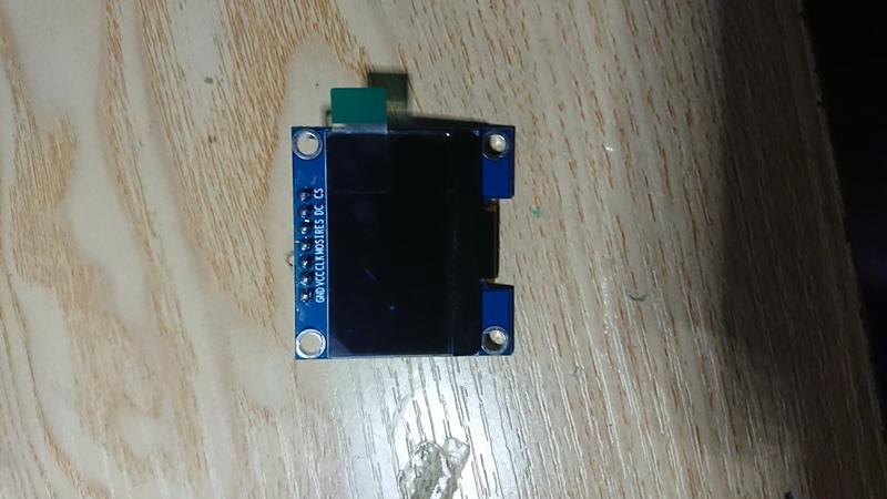

Can anyone please help
I am trying to setup a 1.3" OLED display using SPI
I have a ILI9341 SPi working on these settings:
OPTION LCDPANEL ILI9341, PORTRAIT,GP15,GP14,GP13
if I try and use the SSD1306 on SPI with these settings I dont get any display
option system spi gp18,gp19,gp16
option lcdpanel ssd1306spi,P,gp15,gp14,gp13,2
Any Ideas

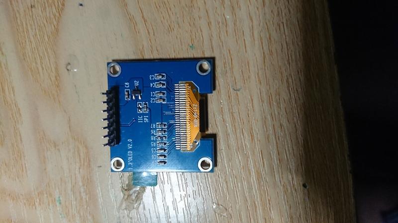

asknik2022
Joined: 26/03/2022
Posts: 94
Posted: 07:23am 20 Mar 2023
Hi I am only using one display the one display at a time.
I am actually wanting to replace the ILI9341 with the SSD1306
I purchased two of these SSD1306's and they both arrived configured as SPI
I converted one of them to I2C and that works perfectly.
However I want to use the I2C for a RTC and hence would rather use SPi for the Display as I have already done using the ILI9341.
Pics below

asknik2022
Joined: 26/03/2022
Posts: 94
Posted: 08:13am 20 Mar 2023
I would rather keep the SSD1306 on SPI as I already have pcb boards made etc.
I am using these on a Raspberry pi pico under mmbasic
This is the pinout is have used between the pico and the display.
GND >> GND
VCC >> VCC (tried 5v and 3.3v)
SCLK >> GP18
SDI(MOSI)>>GP19
SDO(MISO) >> GP16 (not used) (Just configured for option system spi)
RESET >> GP14
DC >> GP15
CS >> GP13
ps.. If I have no option then how do I setup RTC and Display on I2C
If I setup the RTC with option system I2C then I cannot use the grahpic commands on I2C2 as I can't configure both via option system commands. (not that I know of)
I am currently iusing GP0,GP1 for the RTC on I2C
