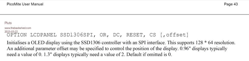

Yes you have to connect all. See the p.44 in PicoMite User Manual MMBasic Ver 5.07.06 (if you are using PicoMite).

This is all it says on page 44 about I2C SSD1306
OPTION LCDPANEL SSD1306I2C, OR [,offset]
Initialises a OLED display using the SSD1306 controller with an I2C interface. This supports 128 * 64 resolution.
An additional parameter offset may be specified to control the position of the display. 0.96" displays typically
need a value of 0. 1.3" displays typically need a value of 2. Default if omitted is 0.
I have converted the display from SPI to I2C so shouldn't I be using
OPTION LCDPANEL SSD1306I2C,L,2

Sorry for the confusion
I understood that you had it working with I2C and wanted to change to SPI.
