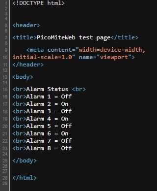

Bit of a strange one (at least to me !)
I have two html files created by Microsoft Expression Web 4 (incidentally free to download and use)
Both files display perfectly when opening directly in various browsers.

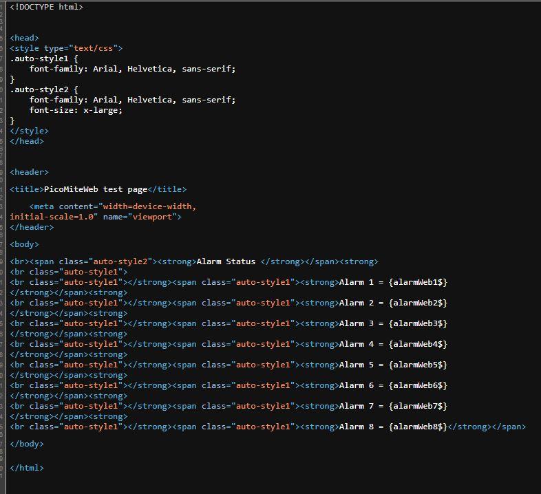

However when I download to Picomite W via MCC Xmodem one displays perfectly and the other one is corrupted.
First one - Displays perfectly and via Picomite
Second one - Displays perfectly when opened direct in browser
However when second one is uploaded via xmodem to Picomite and called to browser via ip address it does not display and is corrupted.
Have tried other HTML editors with no change.
Any ideas gratefully received !

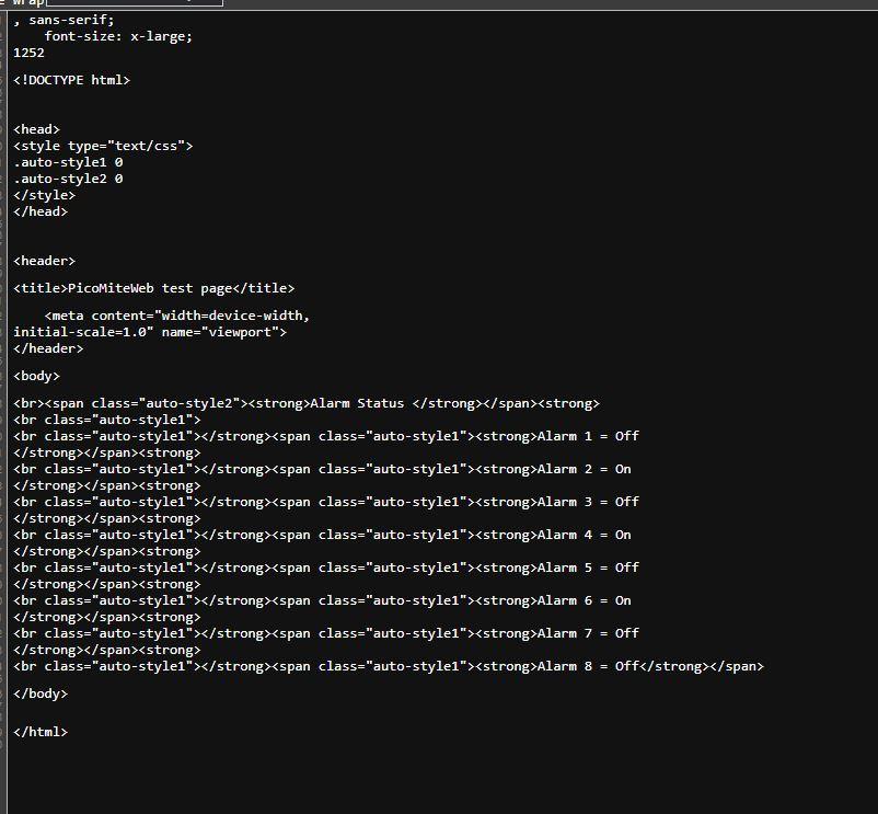

Posts: 11903
Posted: 03:58pm 23 Mar 2023
For reasons I don't understand your html is using a vast amount of either system stack or system heap - I think stack. The text "sans serif" is a result of memory corruption. Now this text  doesn't appear in the firmware anywhere so it must be coming over the web from the host but doesn't appear in the normal html header.
I've made a change, posted in a29, which allows your code to work but if you put a syntax error in the interrupt routine so the program aborts then you can't edit as there is still corruption. I would suggest trying with an external CSS file but this is now beyond my knowledge.

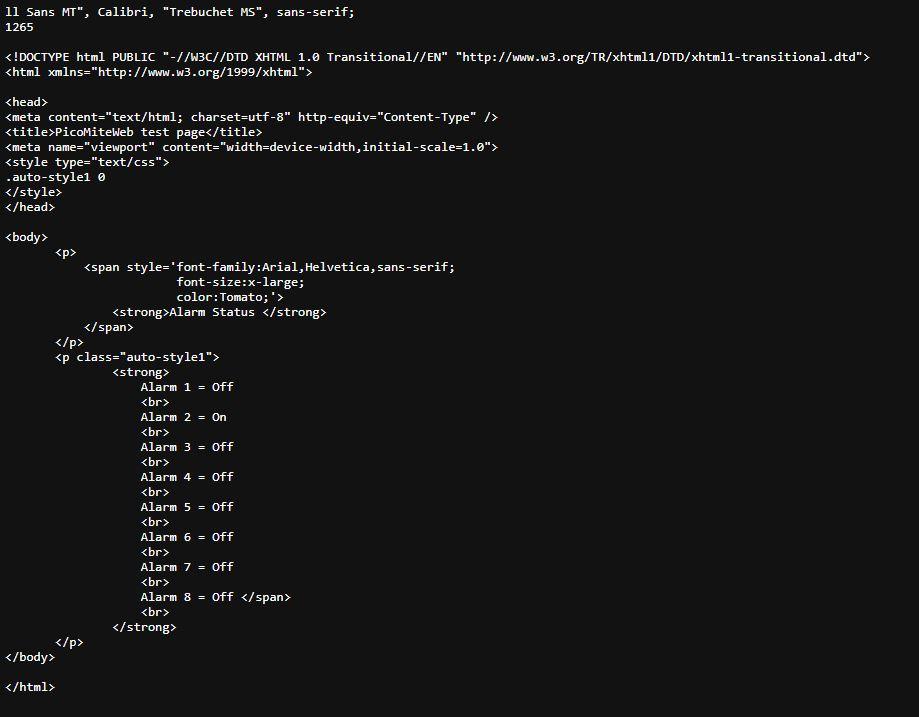

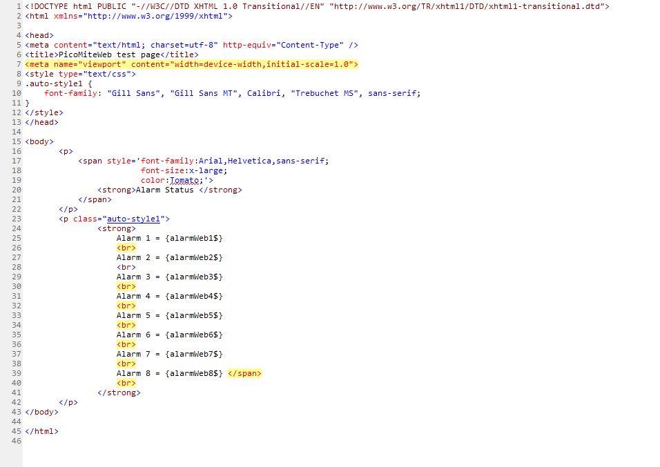

kaptinvimes
Joined: 07/08/2022
Posts: 11
Posted: 10:34am 24 Mar 2023
Tried Doug's html and guess what no problem, however when loading into Expression 4 and  adding a font this is the result as generated
But on running and looking at the page source this is the result
Guessing .auto-style  on line 9 is the cause of the problem ?

Posts: 6608
Posted: 11:09am 24 Mar 2023
Once again, your code has a single { which MMBasic thinks is the start of a variable. Make it a {{ and all will be well again.

kaptinvimes
Joined: 07/08/2022
Posts: 11
Posted: 12:18pm 24 Mar 2023
  TassyJim said  Once again, your code has a single { which MMBasic thinks is the start of a variable. Make it a {{ and all will be well again.
Just realised that these { were added by Expression 4 as in
.auto-style2 {
font-size: x-large;
color: Tomato;
font-family: Cambria, Cochin, Georgia, Times, "Times New Roman", serif;
I missed this and your previous comment had not sunk in
All is good now thank you.
