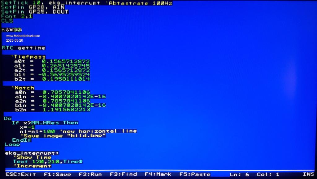

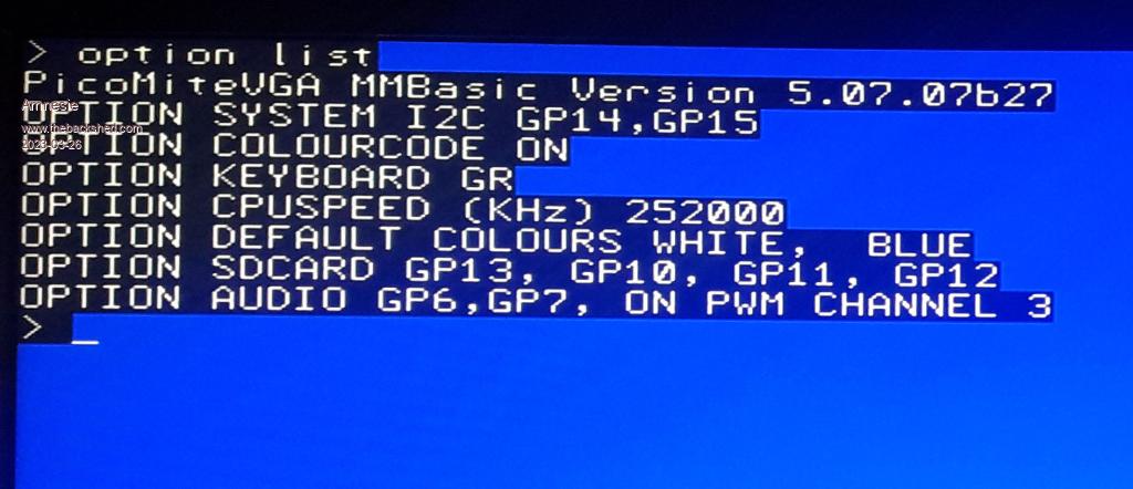

Hello,
after setting
OPTION DEFAULT COLOURS WHITE, BLUE
this happened (mode 1):
I think this was introduced at the time Peter implemented the colour edit in mode 1...
Greetings
Daniel
Posts: 11997
Posted: 10:36am 26 Mar 2023
Thanks - will fix
