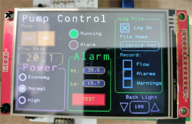

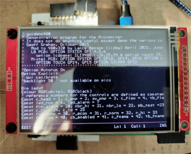

My favorite: ILI9488. It's SPI, but I find the speed for using the editor workable, and the screen size is OK if you can read the letters without difficulty.
Just make sure you get proper ones with touch and not the shift-register maladaptation.

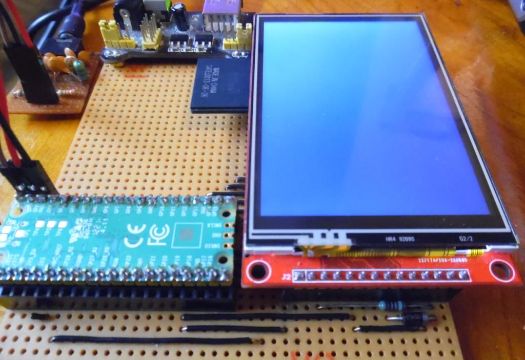

Hi, I got an ili9488, it's a plug in replacement for ili9341 except the sd card pins are 2 cm further apart.
I got a tron game working with touch and play tone and when setting up the display files showed something  so thought sd card ok but when I tried play wav "b:/t1" it says sd card not found.
I had to use a 580R resistor in the miso from the display to touch and sd card miso "GP16" to make the display work but maybe a problem with sd card.
my board takes ili9341 and ili9488 so reverted to ili9341, which seems faster and sd card works.
ili9488 is nice display but there's problems with it from forum posts.

Posts: 2807
Posted: 01:48pm 05 Apr 2023
Thanks phil99 for the link, I posted a breadboard version in that thread.
with a diode and resistor does it All work ie sd card graphics and touch?
Bouncing 16 16x16 sprites seems slower visually with ili9488 than ili9341.
I'll retry ili9488, joys of stripboard over pcb.. easily adapted.
Will a blob of solder short the 1K resistors or will they come off the board and is it reversible with a solder sucker?
Edited 2023-04-06 00:05 by stanleyella

Posts: 2807
Posted: 05:37pm 05 Apr 2023
I tried the resistor/diode solution and it seems to work. touch and graphics and play wav from sd card.. happy days. thanks.
I didn't short the resistors to sd card on the ili9488 but absent minded did on the ili9341 that was on the board and the resistors melted/disappeared and I got to resolder the links cos sd card don't work now.
It was easy to solder the diode in place of the 680r and add the 10k.
My display was cheap "at the time" and nice for my experimenter board.
