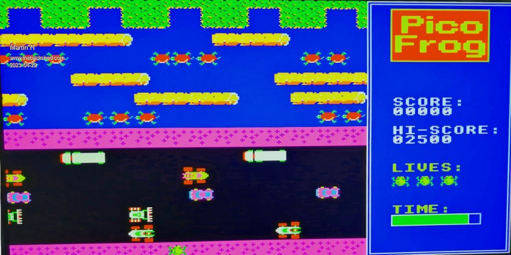

The playable version of a Fogger style game for the PicoMite VGA.
The concept of Frogger is simple. Just get that frog from A to B. Yet it’s a challenge to execute.
The Game:
Move your frog carefuly. Avoid the moving vehicles. On the river, jump across the logs to get your frog to its “frog home”. There are five of these homes, so you have to repeat this four more times.
The Program:
This is the basic structure of the game. What is missing  in this Version are levels, lady-frog, crocodiles, Beaver, Flies and diving Turtles. So there is a lot of room for improvement. Developed on PicoMite Version 5.07.05RC..

Please find attached versions that have been patched to run on Picomite MMBasic 6.
Tested on 6.01.00 on both RP2040 and RP2350.
I had to "assume" a game speed that is determined by variable h_beat%
Change to value to your liking. This was introduced since Peters speed improvements, and the 2350 caused the game to be unplayable (too fast).
I have not tested all controllers in the controller version since I do not own a Atari joystick. I will patch up something tonight and confirm that also works (or issue an update to this release). The keyboard version is fully tested.
