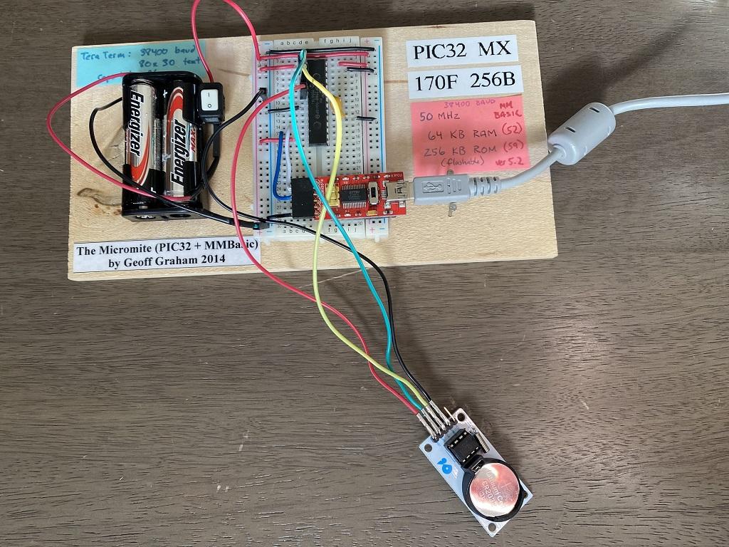

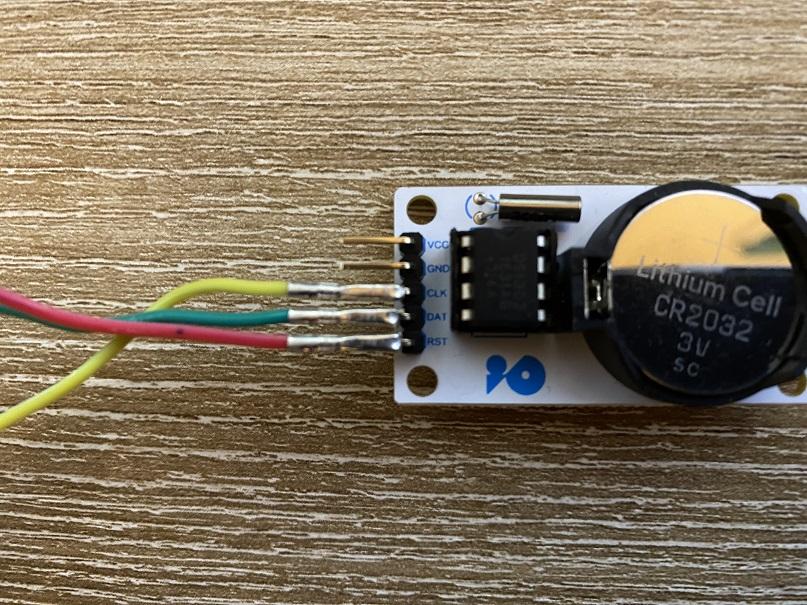

I'm working on a project getting a Micromite (MkII with MMBASIC Ver 5.2) to communicate with a DS1302 RTC module, in order to set TIME$ and DATE$ with the current time/date.
I know the DS1302 isn't on the supported list for the Micromite, at least for modules that support the I2C protocol (the DS1302 does not). But since it's all I have, I thought I'd try to get it to work.

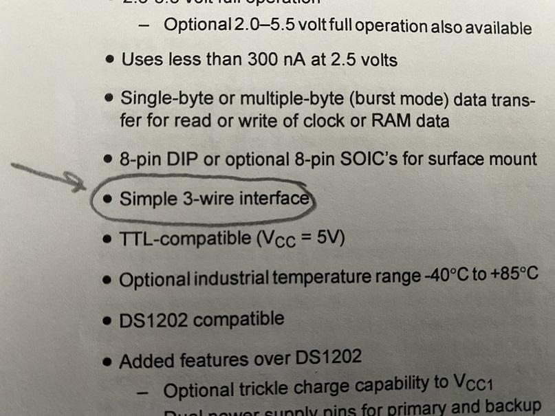

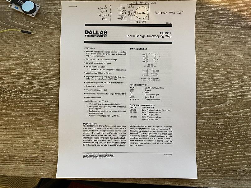

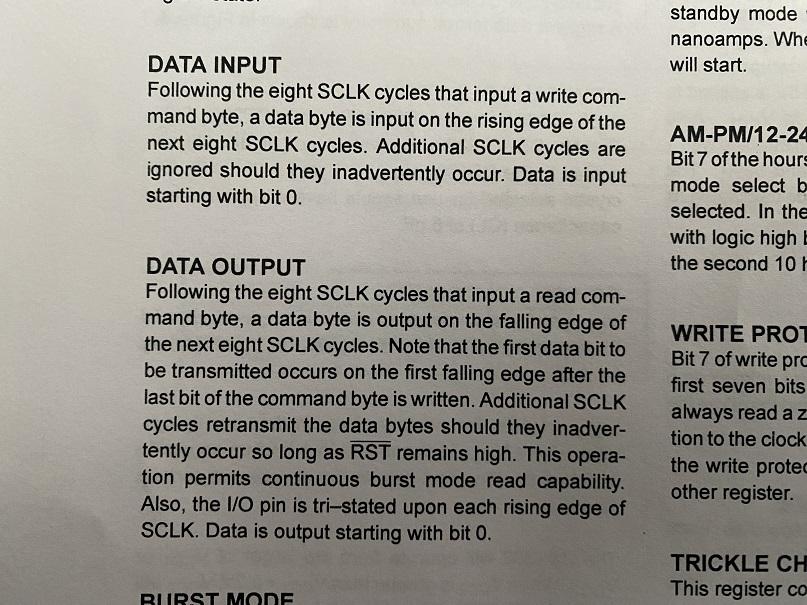

I downloaded the datasheet for the DS1302 (see screenshots) and I'm confused about how to interface it using MMBASIC. There are certain parts that mention things like "simple 3-wire interface" and another section that describes input/output details that make it sound like Mode 2 for the SPI protocol.

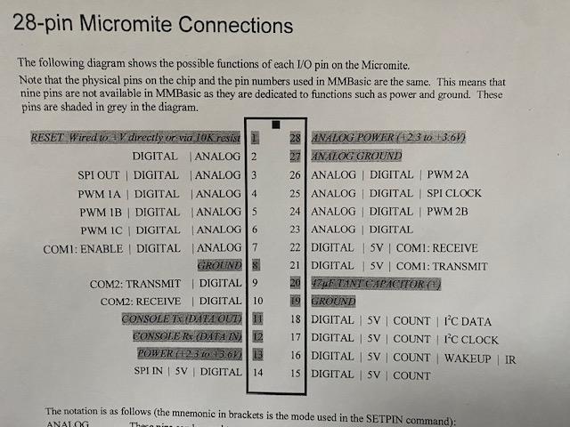

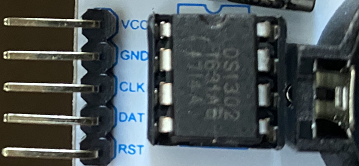

I'm not too familiar with SPI but I know the Micromite has separate lines for SPI IN (pin 14) and SPI OUT (pin 3), so I'm not sure if it's possible to use MMBASIC's SPI functions to work with this module, or I would have to maybe write something from scratch to communicate with it (I'm not entirely sure the module does use SPI either).
The RTC module has 5 pins, and it seems that the Vcc and GND are only used for a second power source, if desired, and don't have anything to do with communicating with the chip (though I could be mistaken).
From this information (and the screenshots) can anyone point me in the right direction of where to start with this?

Posts: 3352
Posted: 12:02am 28 Apr 2023
It appears to be I2C, not SPI and you do need power (2 to 5V - so use 3.3V) and ground to set or read it.
I don't see any pullup resistors in your pics so add 4.7k resistors from 3.3V to SDA (Data) and SCL (Clock) lines. The MM2 does enable its own pullups but they may be too high (100k).
Then try RTC SETTIME. It might be similar enough to a DS1307 to work.

That is the VMA301 and is I2C. You do need to add the pullups.

My bad it is a 3 wire SPI which is why I switched them out for the DS3231 module.
 I had I2C Fram chips I wanted to use.

All these signals are relative to GND so you have to have that. Even the "1-wire interface" needs GND as well as it's signal wire. :)
It isn't I2C and doesn't use I2C protocols, it has its own 3-wire interface. Neither is it SPI. /RST has to be pulled high to activate it for both tx and rx. After that the DAT line is used bi-directionally, in a similar way to I2C.
DAT (I/O} has an internal pulldown.
CLK (SCLK) has an internal pulldown
/RST (CE) has an internal pulldown (it was called /RST on early datasheets)
all about 40k
The VCC pin and battery are isolated by diodes, so whichever has the higher voltage provides power.
https://datasheets.maximintegrated.com/en/ds/DS1302.pdf
I'm pretty certain that it won't be recognised by MMBasic. You'll have to write your own routines to bitbang the /RST CLK and DAT pins.

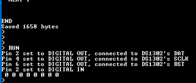

I appreciate all the help! It's definitely helped point me in the right direction. Just to clarify, I'm really just starting out learning electronics and microcontrollers, and so this is a small project, just connecting a DS1302 to a Micromite and seeing if I can get it to work. I'm enjoying the challenge, and learning how to read a datasheet for this (relatively) simple device.
That said, I've made some progress. I believe the DS1302 uses a non-standard 3-wire protocol, and by reading the datasheet I was able to put together some MMBASIC code to test it out.
Screenshots show how I've connected the DS1302 to the Micromite:
 PIN 2 connected to DAT on DS1302
 PIN 4 connected to SCLK
 PIN 6 connected to RST
The source code below just tries to write a certain test byte value (01010101) to the YEAR register in the DS1302, then the program attempts to read that register back again to see if it actually worked.
The results aren't correct, the byte that the program is receiving isn't the test byte I was expecting, but I'll keep trying to figure it out. If anyone sees something wrong with this approach I'd appreciate further feedback. Thanks again.

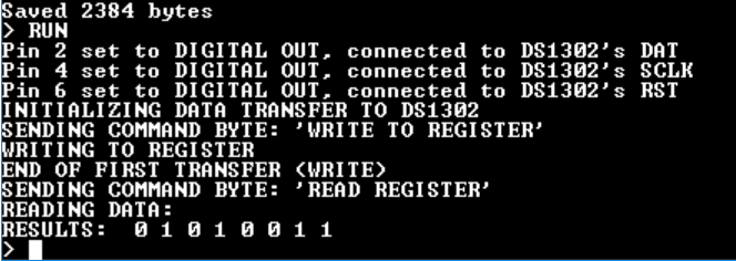

I did some more testing and it turns out the pin labeled "RST" on the VMA301 module gets fed directly to the DS1302's pin labeled "~RST", so I had the settings for that signal backwards in the code above. That didn't fix the problem however.
I'm not sure if it's good practice to switch pin 2 from OUTPUT mode to INPUT mode in the middle of a program, or if that's even possible once it's set. Thinking that was the problem, I connected the DAT line to both pin 2 and pin 26 and set 2 as output and 26 as input. I think this is working better.
dvanaria
Joined: 04/03/2018
Posts: 15
Posted: 12:59am 30 Apr 2023
Ok got it. I was doing several things wrong, but the biggest was that I was bitbanging the command byte to the DS1302 in reverse order, so it was never going to work that way. Below is working code that does a test write to the YEAR register and then reads it back in again.
It turns out you can set an OUTPUT pin to be an INPUT pin later in the same program. I'm not sure if this is bad practice but it was the most straightforward thing to do with this 3-wire protocol the DS1302 uses. I didn't end up running another line out to pin 26 to use that as in INPUT pin.
Here is the demo code. Once I get a full implementation of setting all the registers with the current date/time, and then reading them back into the Micromite to set DATE$ and TIME$, I'll post that final code here in case anyone else is interested.

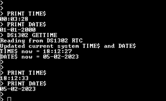

Posted: 12:17am 03 May 2023

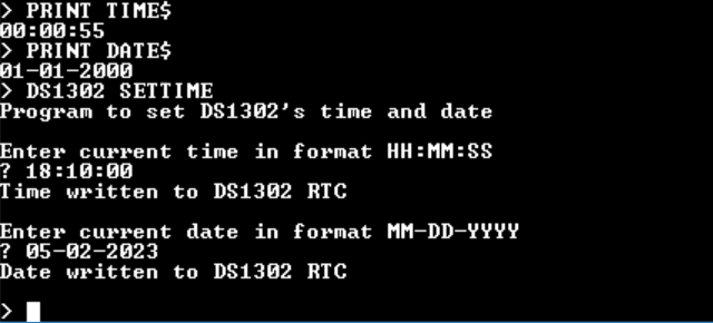

Here is the finished code for this project, just posting it here in case anyone else has use for it. Thanks for all the help!
Screenshots of how the program works are below. I wasn't sure what to call the programs so I went with MMBASIC's "RTC SETTIME" and "RTC GETTIME" pattern and replaced RTC with DS1302 to make it clear.
DS1302 RTC.zip
