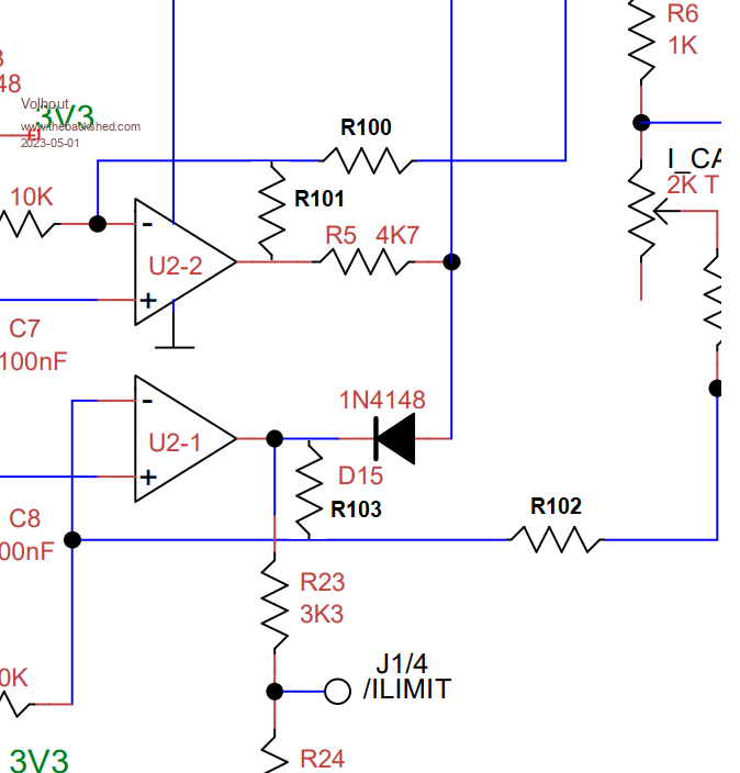

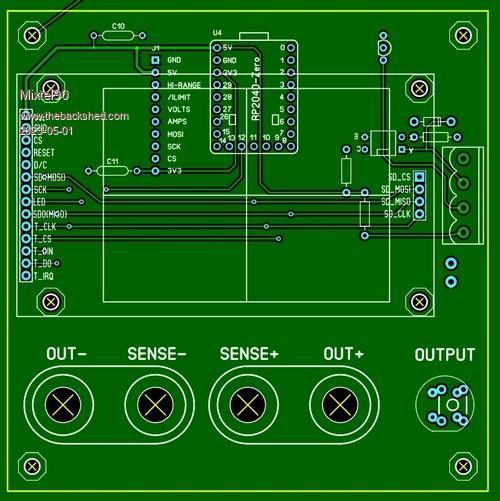

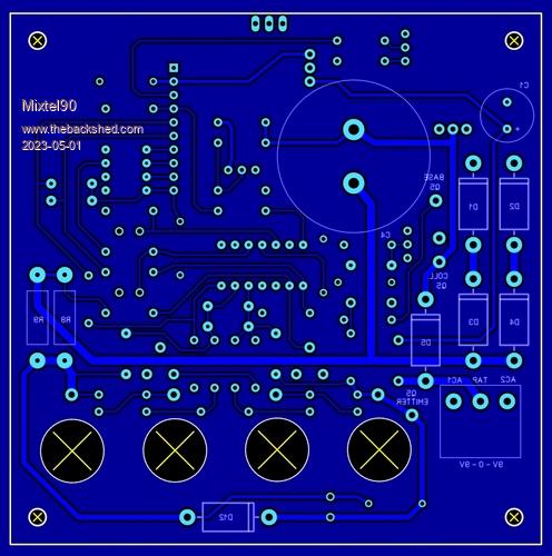

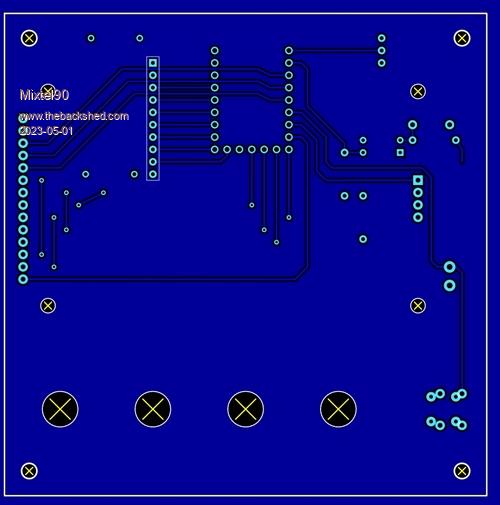

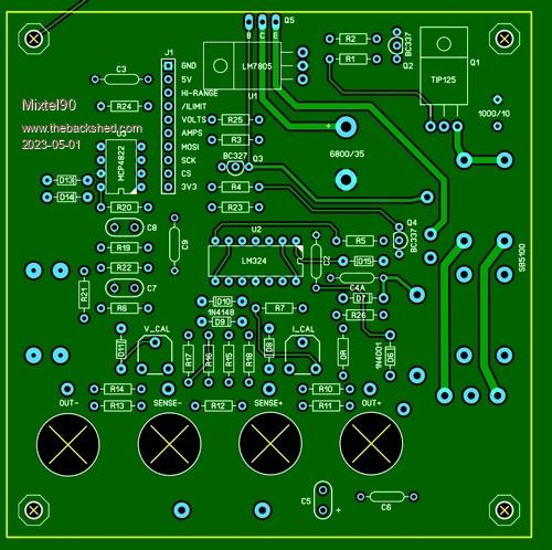

This design has been a bit of entertainment for me for day or three. It's for a lab quality power supply, nothing fancy but hopefully it should do the right things reasonably well. In common with many modern supplies the front end is entirely digital, using a RP2040-Zero for the embedded computing and a ILI9341 for control and instrumentation.
Circuit:
mini PSU 01.pdf
It's a completely linear supply to keep electrical noise down, with digital and analogue circuits on separate PCBs that are stacked together. It's intended to be cased and, in theory, will fit into a case about 110mm wide x110mm high x 150mm deep. To manage that I intend to use a CPU cooler heatsink & fan. It should handle it easily as the maximum dissipation is only about 25W. This isn't a high output supply! To achieve that the input voltage to the regulator can be switched, so below 9V it is halved. Output should be 2A up to 9V then 1A from 9V to 18V.
I've designed some PCBs for it and they *should* be ok, but I've not tested everything.
Don't expect me to rush to make this. I'm notorious for designing power supplies that don't get built. TBH, I'm a little more tempted by this one as it's a manageable size and it has a PicoMite in it. :)

Hi Mick,
At first glance D15 needs to be a shottky diode.
The voltage loop gain seems very high, I expect stability problems. Maybe a resistor in the emitter of Q4?
U2 is powered from 12V, but its inputs U2-3 can be 10v. Is that okay?
Edited 2023-05-01 05:47 by Volhout
Posts: 9038
Posted: 08:19pm 30 Apr 2023
Agreed on your first two points. Loop gain is pretty high. Luckily Q5 has neither very high gain nor very high speed, I don't think. :) Yep, an emitter resistor for Q4 is a good idea - I can always capacitor bypass it to trim things.
Ah - the differential amp...
The LM324 top end of the differential input voltage is VCC-1.7V so I think it will probably survive. lol. Do you think it would be better powered from 24V? It can run off up to 32V. 12V just happened to be handy and it would give me some flexibility for increasing the transformer voltage to 12-0-12 (no longer safe for the LM324).

I've just done a couple of mods. If all the components are mounted on the front of the analogue PCB then you can use 50mm spacers to join it tp the front one, and wire links or something for J2. You can also put Q5 standing up at the back of the board with a small heatsink. This arrangement should be ok for experimentation up to 100mA or so, just to iron out early problems. The holes below the display take standard terminals.

Posts: 6038
Posted: 08:22am 01 May 2023
@Mick,
Additionally I would make this modification. Just to cope with stability problems:
R100/R102 can be 0 ohm to achieve your circuit.
In case of stability probelms you can change R100 and R102 into 10k or so, and R101 and R103 ino either capacitors (roll-off) or into resistors (limit gain).
Edited 2023-05-01 18:23 by Volhout

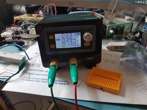

I'm not sure if this pic belongs here or on the workshop thread! However, I've finally got a bench power supply that's small enough at 100mm wide and 80mm deep. :)
All the clever stuff is in a single Chinese module from ebay. I've added a 7508 regulator to feed a USB socket and a sort of temperature controlled fan that still needs work on it. :) It's a buck-boost converter and is powered from a 19V power brick. Max output is 30V, min is 0.6V and it can dissipate 35W according to the spec (not tested). I'm still getting the hang of the control system, which is slightly weird as expected. Seems to work quite nicely but is a bit "sluggish". I get the feeling that there is too much capacitance across the output, but hey, what do you expect for that price? It beats any LM317 design for flexibility hands down.

Posted: 11:28am 28 May 2023
Nice build-out. I have and like the module (for the same reason--space occupied), but haven't customized it.
Posts: 9038
Posted: 11:48am 28 May 2023
I had an even smaller version (just the front half of this box) with a different module but there was no cooling and I eventually bricked the module by accidentally setting OVP to zero. Now I can't even get to the settings screen to fix it! No great loss as the text was tiny and setting things was a pain. I'm now considering re-using the case and fitting a different insides to make a general purpose audio oscillator of some sort.

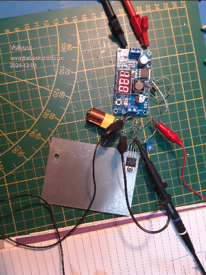

Hi Mick,
Just thinking about your idea for a pico based power supply. I know you are already equipped, but I wanted to share this photo. It is of a cheap chineese LM2596 design (this is with display, but I essentially need one without) that is a pre-regulator for an LM317. It makes sure there is 3V across the 317, so even at 1A it dissipates only 3W.
Tracking works nice. Only the chineese (3A specification) circuit gets warm at 1A. Input capacitor, output capacitor, inductor, and switcher IC. The ripple at the switcher output is 4Vpp (at 1A !). I am glad there is an LM317 to filter this. The LM317 produces 10.016V at 1A in below test. The ugly big inductor is just a test. This will become as 10mm one.
I plan on using the 4822 DAC, same as you. So there will be an LM358 added, and adjustable current limit,
