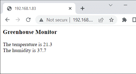

To encourage people to try out the WebMite I have included a demonstration web server (program + web page) in the WebMite download.  It uses a DHT22 humidity/temperature sensor to monitor the conditions in a fictional greenhouse.  The program is only 17 lines long and the Web page is just 3 lines.  It does not get much simpler than that.
This is what you might see in your browser:
Geoff
