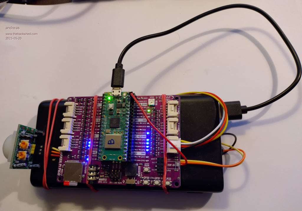

This pico w has connected a PIR motion sensor connected to pin gp6
I want to get the motion detection signals on any pc/mobile by using a mqtt subscription to a mqtt message broker.

And this is "webmiteb" the sensor pico connected to the PIR, akku and maker pi pico pcb.

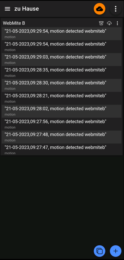

By the way, I found a very nice Android app "IoT MQTT Panel" which works very good with the mosquitto MQTT broker on the raspberry Pi! There one can create a monitoring panel and add all the sensors.
I have a wireguard VPN between my mobile phone and the FritzBox - so I'm allways connected to my lan and can monitor the picos without opening a port or service to the WAN side of the FritzBox. Even my nextcloud is accessible from everywhere without opening a web port. ;-)
