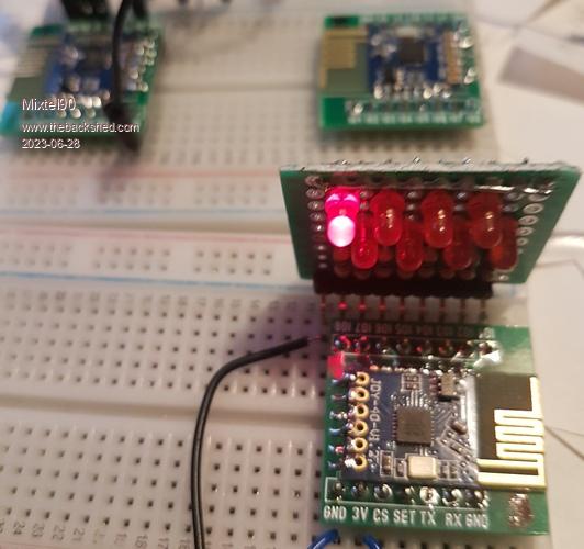

EDIT:
YAY! My little breakout boards for the JDY-40 work. They let you plug them into ordinary breadboards, with all connections on pins.
Incidentally, I had no luck in attempting to program the JDY-40 using Tera Term. I used YAT, which had no problems at all. I suspect that Tera Term is sending character by character and YAT sends a complete line terminated by CR LF.
Edited 2023-06-28 06:55 by Mixtel90
