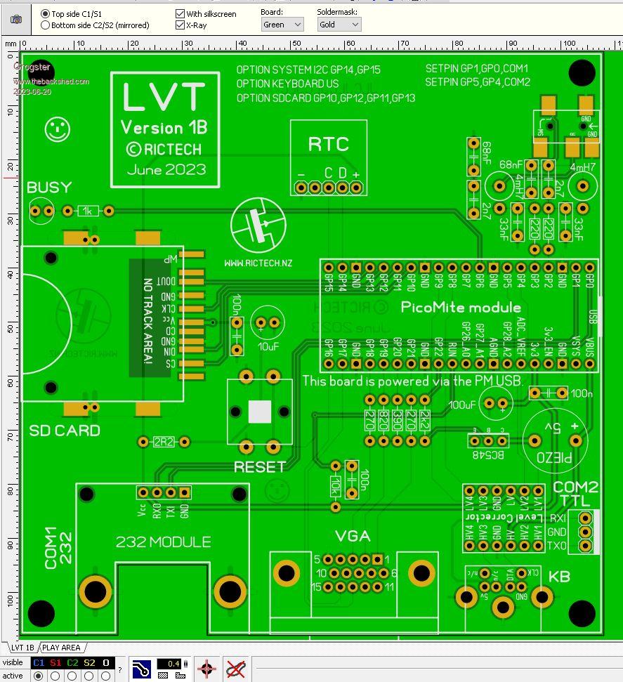

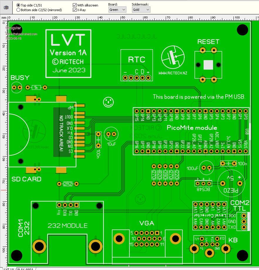

I needed something simple for logging serial data, and decided something that would use the monitor's standard VESA mounting holes could be useful.
In my case, it uses the 100mm VESA standard.
Its primary use, is logging anything received on COM1(RS232), to an SD card file, but I have also routed out COM2, which is 5v tolerant via the level-corrector.
Nothing fancy, but it mounts neatly on the back of any monitor with 100mm VESA mounting holes, and is powered by the USB cable, as many monitors now have a USB port, so it becomes very neat and self-contained.
If anyone is interested, let me know, and I can compile and upload a constructors pack in the form of a ZIP file.

Might be an idea to add 100nF across the reset button and, possibly, a 10k pullup. Just thinking, it's hardly a noise-free location. Personally, I'd increase the base resistor of the BC548 to about 1k or even 2K2. hFE is going to be over 100 so that's fine. The transistor can only handle 100mA anyway. There's no point in loading the PicoMite output unnecessarily.

I just noticed the silkscreen is wrong.  548 base resistor is indeed 2k2, but I have it listed there as 220 - silkscreen typo.
The 5v piezo is just there to "Beep" on receipt of a message, to draw your attention to the screen, but I am not even sure if I will even use it - but better to have it and not need it, then to need it and not have it.
Could add the 100n/10k to the reset button, but so far, noise from the monitor has not proven to be a problem - yet.

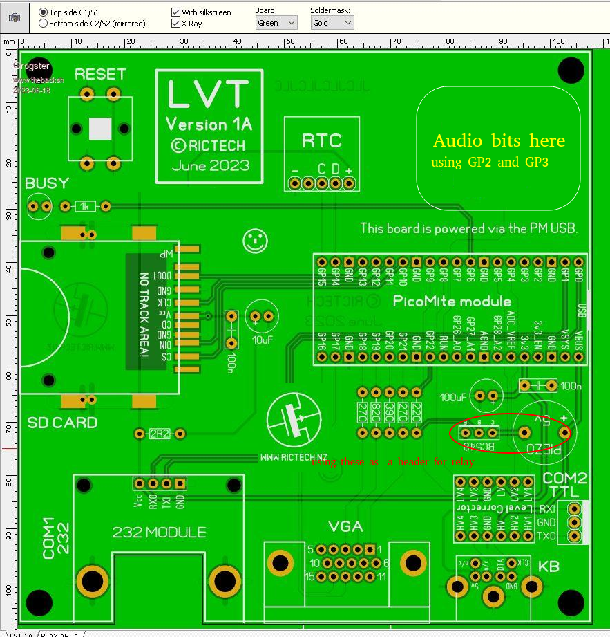

Just a thought a few of my thin line LCD VGA monitors have speakers that you
 could play flac files from the SD card giving more information on any alert.
 I could give vocal setup and calibration instructions to operators make things
 very cool more what todays technicians kind of expect from us.
 The Picomite has it built in just need the very basic hardware to make use of it.
 Or a sea of holes with header of unused pins from the Picomite.
 Even pull diagrams from SD to go with vocal instruction. DAM this is WOW
 I like the idea of this being a front end to a group of Picomite controllers.
 RS232 very good range and the controllers can daisy the RS232.

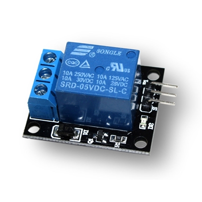

 One other thought add a relay that could be activated.
 For my use power down all pumps and fire the tower alert beacons.
 Best is MMBasic is there on this and my controllers.

Hope it ok here is a markup of your board.
 A picture in place of paragraph.

@ Quazee137 - how does this suit?
- RESET button moved, and now has 10k pull-up and 100n decoupling to satisfy Mick.
- Standard audio LPF added.
- SMD 3.5mm stereo socket added.
- OPTION's and SETPIN's for this board added to silkscreen.
Happy?
Not bothered with the relay header, as you can simply NOT install the 5v piezo, and put PCB-pins in its place, and then wire an external relay to those pins.  You will need to put a back-EMF diode across the external relay coil though, or the 548 transistor will self-destruct.
Also, be aware that the 548 is only rated for 100mA.
That was fine for driving a wee piezo beeper, but if you planned to drive a relay, I would swap that for a BC337 which can handle much more current, but has the same CBE pinout.

 About the header comment.
 I was just going to solder pins to what you have already there.
 The idea is to jumper the +5 to the other piezo pin and use the ebc
 as a 3 pin header to drive one of those cheap optical driven modules.
