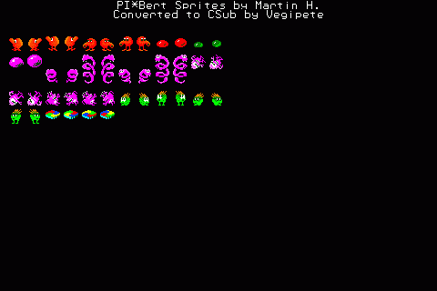

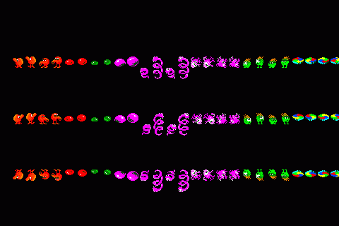

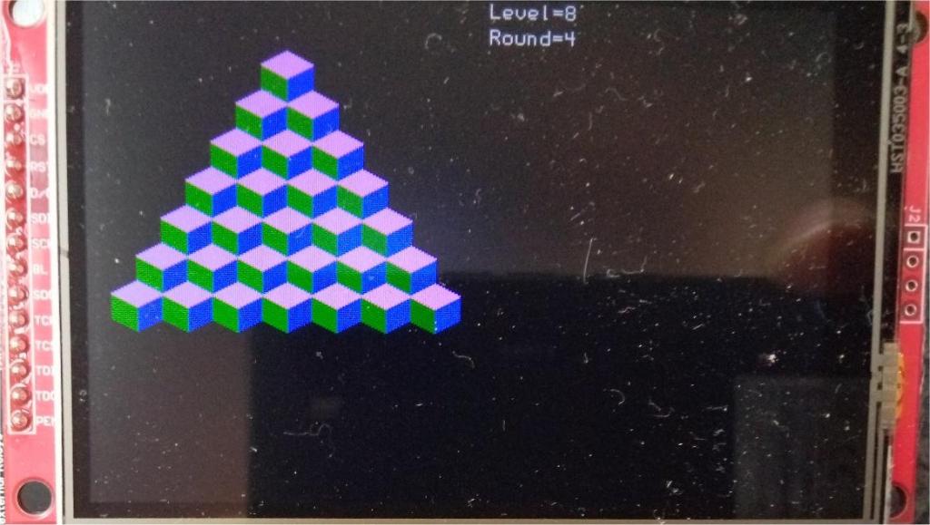

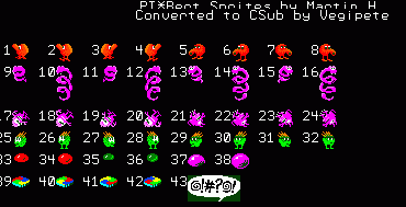

I started to design a Q*Bert-like game for the Pico.
Unfortunately, I don't have the time, at the moment, and patience to create a finished game out of it .
I have already designed the pyramids for 8 levels of 4 rounds and all the sprites.
I would be happy if someone here could finish programming this.
Does anyone dare to do that for PicomiteVGA and/or LCD (Tomboy)?
Mart!n

'Draws the playground in colors 1 (top) 2 (left) and 3 (right)
Sub pyra C1%,c2%,c3%
 tx%=112
 For y=0 To 6
   For n=0 To y:field tx%+32*n,32+24*y,c1%:block tx%+32*n,40+24*y,c2%,c3%:Next
   Inc tx%,-16
 Next
End Sub

Running on standard PicoMite with 480x320 ILI9488 LCD after replacing "SPRITE" with "BLIT".
Commenting out the first line, "MODE 2" it ran to line 114:  blit show 2-(of%=7), x%, qy%-sw%(of%), 2,1
I commented that out and it ran to Level 8, Round 4, flashing many colors in a triangle of apparent cubes of which you can see three sides (which appear to be the same shape in different orientations).
It crashed at line 59, Blit write n,x+160,y,1
This is what a screen shot looks like after the crash:
I commented out line 59 and then it runs to the same point, Level 8, Round 4, and then, after a pause, it repeats.
(I have no idea what might happen if those lines were not commented out, and know nothing about the game.)

On a picomite with ILI9488 480x320 LCD, here's a screen shot of the sprites in normal orientation and flipped with Peter's new code for BLIT WRITE which allows mirroring:
After the sprites are read in and built:
For n=1 To 26: Blit write n,n*18,80: Blit write n,n*18,160,1: Blit write n,n*18,240,2:Next
That's how they're supposed to look.

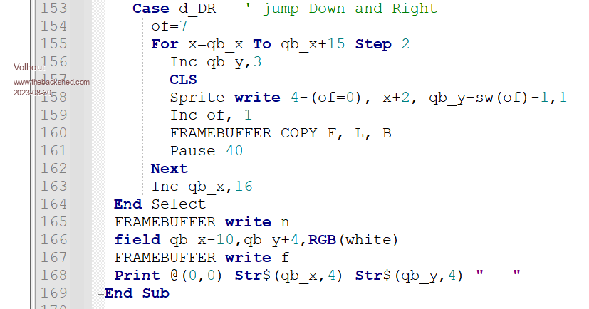

Posted: 09:09am 30 Aug 2023
Nice...very smooth moves...
You did not color the top tiles yet...
Insert lines 165..167

That's what it looks like on a PicoMite with ILI9488 with this code:
'autosave
Option DEFAULT INTEGER
If MM.Device$="PicoMiteVGA" Then
 MODE 2
Else
 FRAMEBUFFER create
 FRAMEBUFFER write F
EndIf
Dim glof(50)
Restore GlyphOff
Read n : glof(0) = n
For i = 1 To n:Read glof(i):Next
CLS
Text MM.HRes/2,0,"PI*Bert Sprites by Martin H.","CT"
Text MM.HRes/2,10,"Converted to CSub by Vegipete","CT"
spad=Peek(cfunaddr Glyphs)
x = 10 : y = 40
For i = 1 To glof(0)
 Blit memory spad+glof(i),x,y
 Inc x,20
 If i = 12 Then x = 10 : Inc y, 20
 If i = 24 Then x = 10 : Inc y, 40
 If i = 36 Then x = 10 : Inc y, 20
Next i
If MM.Device$="PicoMite" Then FRAMEBUFFER copy f,n
End
I don't know if the blank sprites are supposed to be blank.

Posts: 6254
Posted: 12:05pm 18 Sep 2023
Hi lizby,
Your image is okay.
There are no blank sprites. Some are vertically larger....
Posts: 3888
Posted: 12:19pm 18 Sep 2023
  Volhout said  Some are vertically larger....
Ah, got it. Thanks.
