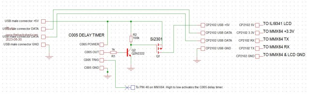

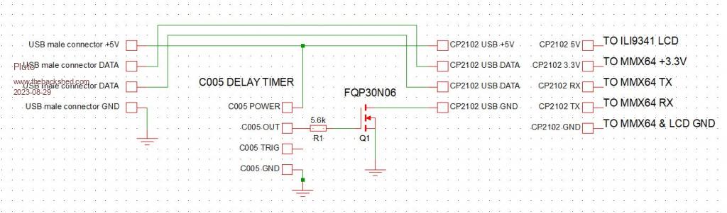

My circiut looks like this:
A much smaller FET shold have been sufficient, but this is just a testcircuit.
As you can see it puts also the LCD into SLEEP.

The MicroMiteExtreme 64 and the connected LCD switches ON/OFF/ON/OFF.... and displays properly.
The only problem is that console prints OK numbers after some start-ups and rubbish after other start-ups. Can it have something to do with that the power is cut on the GND line to CP2102??
Would of course be nicer to cut the power on the +5V line to CP2102, but probably some more components?

What current does the MicroMiteExtreme 64 draw when the reset pin is held low?
If it is low enough remove the FET and use a voltage divider (18k + 33k perhaps) to drive the reset pin.
Otherwise the output of the N-channel FET can drive a P-channel FET in the 5V line.

  Quote  Otherwise the output of the N-channel FET can drive a P-channel FET in the 5V line.
Just tested with P-channel FET in the 5V line. Works much better!
