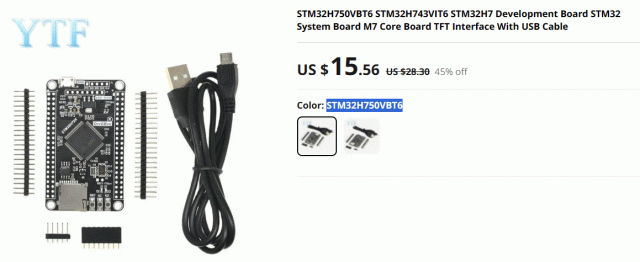

This board
The option STM32H743VIT6
It is VIT6, not VIIT6, have much diferences? this board will work?
Thank you in advance.
MMBasic 5.0707 on PicoMite VGA

Link does nothing, sorry.
Posts: 3857
Posted: 12:05pm 02 Sep 2023
Searching on aliexpress for the item number in the malformed link shows this
This is an H7 board.

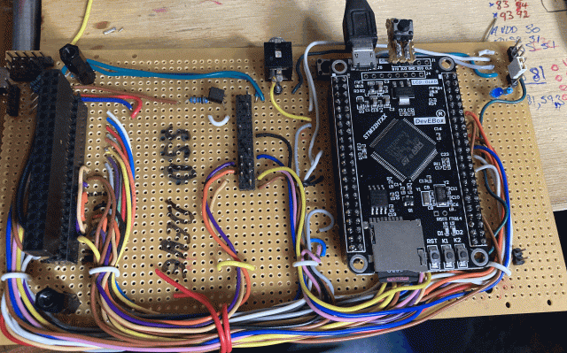

The STM32H743VIT6 backpack.

@ice2642 link:
https://pt.aliexpress.com/item/1005005415869986.html?spm=a2g0o.cart.0.0.4e407f06H6JFWQ&mp=1&gatewayAdapt=glo2bra
You can select one or the other.

ice2642
Joined: 27/05/2023
Location: Brazil
Posts: 82
Posted: 01:24am 05 Sep 2023
Thank you all!
It was the link :) I do not know wat happens when I post the link.
I will buy the option STM32H743VIT6
