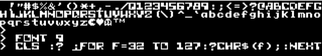

Here are the Amiga Style Fonts that came with GrafX2 in the "(Amiga)DPaint style paint program for Windows" Topic.
I converted the pngs to Black an White and let mmbasic4w do the work.
you can also Paint your own fonts in a 32x8 Grid and convert it like this.
(remember the Mites can not load display Chars lower 32 in a Font)
'png to Font Converter .. Martin H.
'works on MM_Basic 4 Windows
'fonts on the PNG are on a 32*8 grid each 8x8 Pixel in Black/White
'so chr$(32) starts at position 0,8 , chr$(64) at 0,16 etc.
'*** User part  ***
'File name, number of chars, first char and size
'chars lower 32 couldn't be converted
fname$="font_Seen"
chrs=224:Start =32:W=8:H=8
cls
load png fname$+".png"
open fname$+".bas" for output as #1
?#1,"' ";fname$
?#1,"' Font type    : Full (";str$(chrs);" Characters)"
?#1,"' Font size    : ";str$(w);"x";str$(H);" pixels"
mem=(W/8)*H*chrs
?#1,"' Memory usage : ";STR$(mem)
?#1,"DefineFont #9"
?#1,hex$(chrs,2);hex$(start,2);hex$(h,2);hex$(w,2)
for y=h to 56 step H
for x=0 to 248 step w
hx$=""
  for y1=y to y+h-1:v=0:b=128
   for x1=x to x+w-1
   if pixel(x1,y1)=RGB(White) then Pixel x1,y1,rgb(green):inc v,b
   b=b>>1
next x1
  hx$=hex$(v,2)+hx$
  next y1
?#1 ,right$(hx$,8);" ";left$(hx$,8)
next x
next y
?#1,"End DefineFont"
close #1
Fonts and pngs in the Zip File
Fontconvert.zip

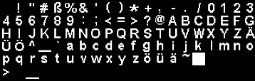

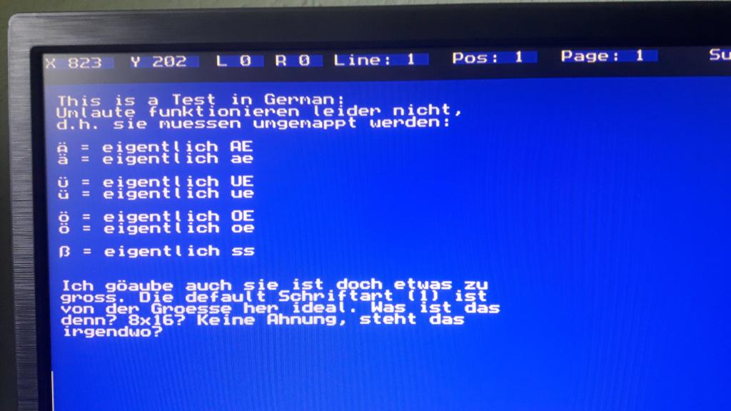

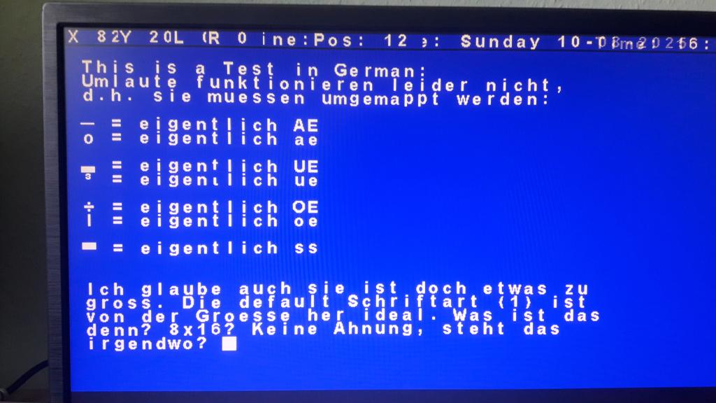

Hello Martin!
This is really good work and especially the Amiga Font is interesting, since it has Umlaute (ÄäüÜ etc. for english people here).
But can they (Umlaute) be used by this font? It looks like this font is way bigger in (image) size. Sorry for this newbe question. I am more a hardware guy and still learning.
I am also using a custom made font, which I painted via Photoshop (added Umlaute) and placed them on different keys, then routed them to the correct physical keys on the keyboard. A bit of a workaround but in the end it is quite cool to have our common German Umlaute    I needed them for a pseudo text editor I am working on.
My font:
I am just wondering whether all of your characters in the Amiga font are available...
Greetings
Daniel
Edited 2023-09-09 22:14 by Amnesie
Martin H.
Joined: 04/06/2022
Posts: 1574
Posted: 02:12pm 09 Sep 2023
  Amnesie said  Hello Martin!
My font:
Greetings
Daniel
Hi Daniel,
The Amigafonts uses the whole range from Chr 32 to 255 (224 Chars), the LodeRunner- and the BBC Font just 32 to 127 (96 Chars).
The Fonts I used till now, are all 8x8 Pixel
The Font on your image uses 16x16, before I can create a Font file I have to find out, how they have to be encoded  .
But for now, to keep you workling, I changed the BBC Font to "Umlauts"
hope that helps
' font_BBC_uml
' Font type    : Full (96 Characters)
' Font size    : 8x8 pixels
' Memory usage : 768
DefineFont #9
60200808
00000000 00000000 18181818 00180018 006C6C6C 00000000 6CFE6C6C 006C6CFE
D8C8C8F0 C0DCC4C4 3058AC46 0084CA64 76386C38 0076CCDC 00301818 00000000
30303018 00183030 18181830 00301818 3C7E1800 0000187E 7E181800 00001818
00000000 30181800 7C000000 00000000 00000000 00303000 180C0602 00C06030
7E6E663C 003C6676 18183818 007E1818 0C06663C 007E3018 1C06663C 003C6606
6C3C1C0C 000C0C7E 067C607E 003C6606 7C60301C 003C6666 180C067E 00303030
3C66663C 003C6666 3E66663C 00380C06 18180000 00181800 18180000 30181800
6030180C 000C1830 007C0000 0000007C 0C183060 00603018 180C663C 00180018
AA9A423C 003C409C 7E66663C 00666666 7C66667C 007C6666 6060663C 003C6660
66666C78 00786C66 7C60607E 007E6060 7C60607E 00606060 6E60663C 003C6666
7E666666 00666666 1818187E 007E1818 0C0C0C3E 00386C0C 70786C66 00666C78
60606060 007E6060 6B7F7763 0063636B 7E766666 0066666E 6666663C 003C6666
7C66667C 00606060 6666663C 00366C6A 7C66667C 0066666C 3C60663C 003C6606
1818187E 00181818 66666666 003C6666 66666666 00183C66 6B6B6363 0063777F
183C6666 0066663C 3C666666 00181818 180C067E 007E6030 66241842 0066667E
66660024 003C6666 66241842 00182466 00663C18 00000000 00000000 00FE0000
00183030 00000000 063C0000 003E663E 667C6060 007C6666 663C0000 003C6660
663E0606 003E6666 663C0000 003C607E 7C30301C 00303030 663E0000 3C063E66
667C6060 00666666 18380018 003C1818 18380018 70181818 6C666060 00666C78
18181838 003C1818 7F360000 0063636B 667C0000 00666666 663C0000 003C6666
667C0000 60607C66 663E0000 07063E66 766C0000 00606060 603E0000 007C063C
307C3030 001C3030 66660000 003E6666 66660000 00183C66 6B630000 00367F6B
3C660000 00663C18 66660000 3C063E66 0C7E0000 007E3018 063C0024 003E663E
66660024 003E6666 663C0024 003C6666 CCD66600 00000000 C66C3810 00FE8282
End DefineFont

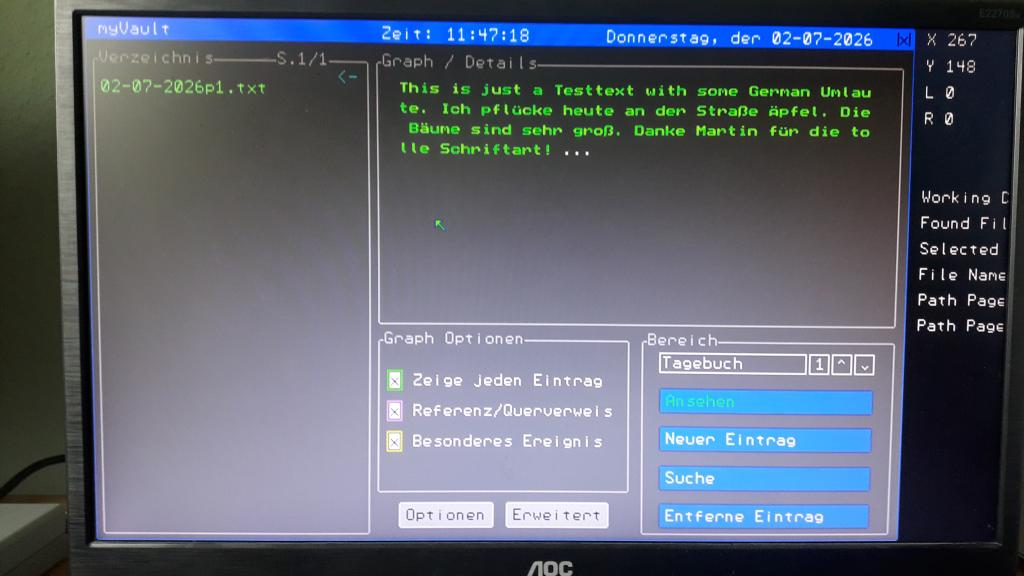

Amnesie
Joined: 30/06/2020
Posts: 763
Posted: 06:16pm 09 Sep 2023
Hi Martin!
Thank you a lot, this is really great! My long term project is to program a simple text editor, and if I want to write in German, "AE" looks dumb and is in my opinion not a good alternative for "Ä". I know a lot of programmers don't care about "ae" or "ue" but for me it's just awful
Thank you!

Classic Sinclair Font  & some UDGs
' font_ZX by Martin Herhaus
' Font type    : Full (128 Characters)
' Memory usage : 1024
DefineFont #9
80200808
00000000 00000000 10101000 00100010 00242400 00000000 247E2400 00247E24
283E0800 083E0A3E 08646200 00462610 10281000 003A442A 00100800 00000000
08080400 00040808 10102000 00201010 08140000 0014083E 08080000 0008083E
00000000 10080800 00000000 0000003E 00000000 00181800 04020000 00201008
4A463C00 003C6252 08281800 003E0808 02423C00 007E403C 0C423C00 003C4202
28180800 00087E48 7C407E00 003C4202 7C403C00 003C4242 04027E00 00101008
3C423C00 003C4242 42423C00 003C023E 10000000 00100000 00100000 20101000
08040000 00040810 3E000000 00003E00 08100000 00100804 04423C00 00080008
564A3C00 003C405E 42423C00 0042427E 7C427C00 007C4242 40423C00 003C4240
42447800 00784442 7C407E00 007E4040 7C407E00 00404040 40423C00 003C424E
7E424200 00424242 08083E00 003E0808 02020200 003C4242 70484400 00424448
40404000 007E4040 5A664200 00424242 52624200 0042464A 42423C00 003C4242
42427C00 0040407C 42423C00 003C4A52 42427C00 0042447C 3C403C00 003C4202
1010FE00 00101010 42424200 003C4242 42424200 00182442 42424200 00245A42
18244200 00422418 28448200 00101010 08047E00 007E2010 08080E00 000E0808
20400000 00040810 10107000 00701010 54381000 00101010 00000000 FF000000
78221C00 007E2020 04380000 003C443C 3C202000 003C2222 201C0000 001C2020
3C040400 003C4444 44380000 003C4078 18100C00 00101010 443C0000 38043C44
78404000 00444444 30001000 00381010 04000400 18240404 30282000 00242830
10101000 000C1010 54680000 00545454 44780000 00444444 44380000 00384444
44780000 40407844 443C0000 06043C44 201C0000 00202020 40380000 00780438
10381000 000C1010 44440000 00384444 44440000 00102828 54440000 00285454
28440000 00442810 44440000 38043C44 087C0000 007C2010 30080E00 000E0808
08080800 00080808 0C107000 00701010 00281400 00000000 A199423C 3C4299A1
AA54AA54 AA54AA54 0F0F0F0F 00000000 F0F0F0F0 00000000 FFFFFFFF 00000000
00000000 0F0F0F0F 0F0F0F0F 0F0F0F0F F0F0F0F0 0F0F0F0F FFFFFFFF 0F0F0F0F
00000000 F0F0F0F0 0F0F0F0F F0F0F0F0 F0F0F0F0 F0F0F0F0 FFFFFFFF F0F0F0F0
00000000 FFFFFFFF 0F0F0F0F FFFFFFFF F0F0F0F0 FFFFFFFF FFFFFFFF FFFFFFFF
423C0042 00427E42 423C0042 003C4242 42420024 003C4242 50483000 00484448
04380028 003C443C 44380028 00384444 44440028 00384444 806010E0 000000F0
10E010E0 000000E0 54545CF4 00000000 82AA4438 003844BA FED67C38 00387CC6
FEFEFE6C 0010387C FE7C3810 0010387C FED63838 003810D6 FE7C3810 0038107C
End DefineFont
