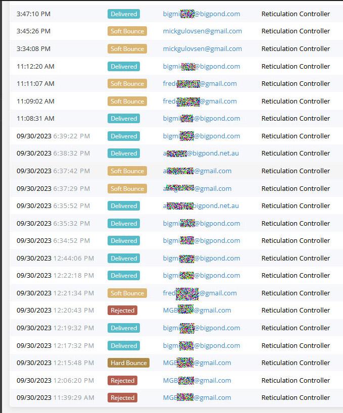

Posts: 2982
Posted: 04:52am 01 Oct 2023
Hi Geoff, All,
I have just created a new GMAIL acct and email, this time simply my name (as suggested by google) I can send to this email using my normal thunderbird email program but using the Silicon Chip Reticulation program I do not receive any test messages, I have attempted 3 or 4 times.
If I set my bigpond email address the reports come through within a few seconds.
I might email SMTP2GO and ask them if they block certain emails.
Posts: 2982
Posted: 05:00am 01 Oct 2023
Geoff, All,
It looks like it IS SMTP2GO filtering emails.
See this `activity log' on SMTP2GO.com
As you can see, every GMAIL send attempt is either Rejected, Hard Bounce or Soft Bounce including to AndrewG's GMail accts.
I will do some reading on this.
It is strange that yours go through OK Geoff.
Edited 2023-10-01 15:05 by bigmik
Posts: 3369
Posted: 07:40am 01 Oct 2023
There is a huge amount of effort being put into reducing spam by Google and others.  This includes AI scanning, blacklists, domain verification, etc.  Any of this could be the culprit.
It looks to me that your emails have been rejected by Google so it is not the fault of SMTP2GO.  In the past I have been tripped up by Email authentication protocols such as SPF, DKIM, and DMARC and it sounds as if they are your problem.  Check this paper by Google and  this paper

Posts: 2982
Posted: 07:59am 01 Oct 2023
Hi Geoff, all,
Yes, on reading SMTP2GO FAQ, it is most likely DMARC but I don’t think I would be able to change anything for that to work.
It isn’t a major drama, I will just create another email address on my Bigpond account.
I just wanted to know if everyone has this issue, what is strange is that your Gmail works.
Anyway, thanks Geoff and for your work on the Reticulation controller, now to work out how you do it so I can add that code to my code.
