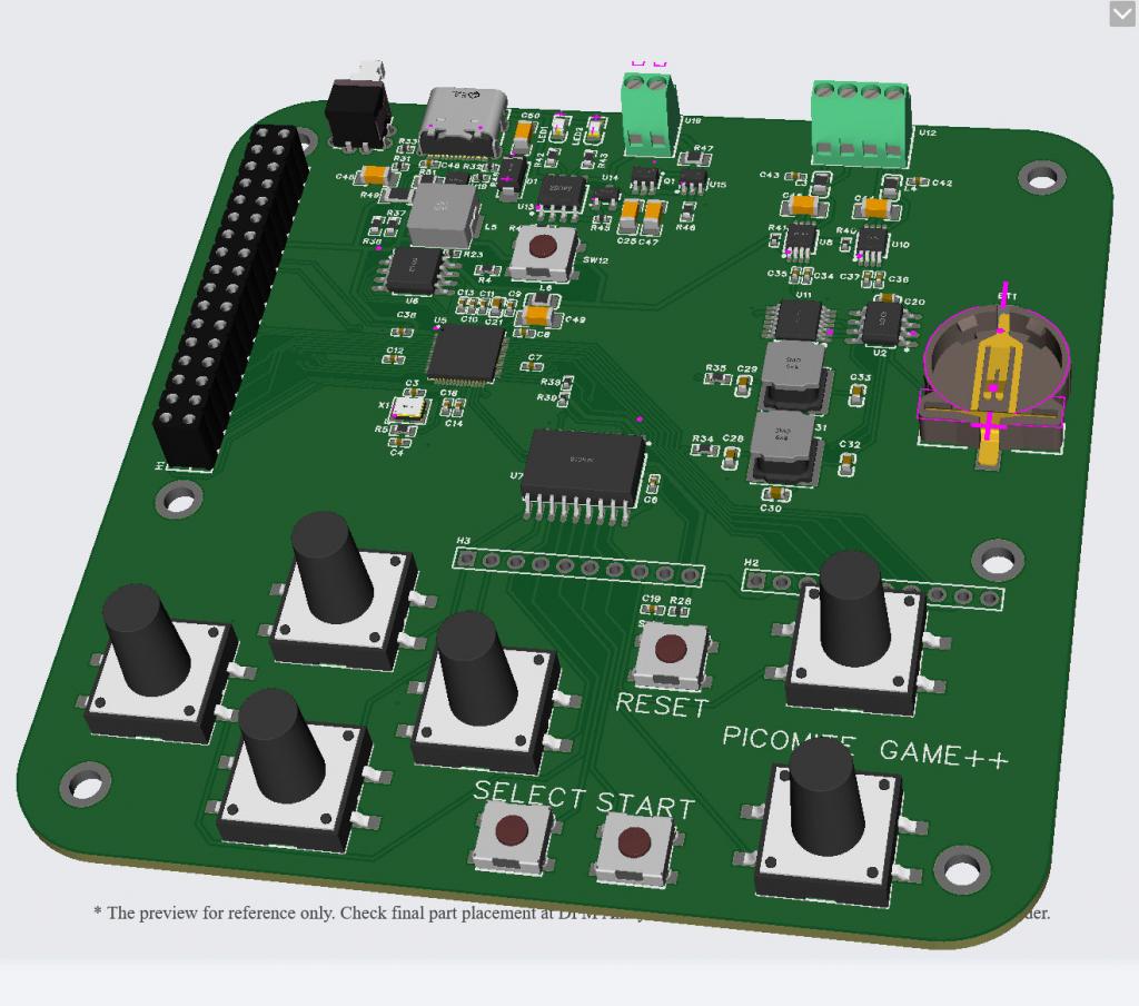

I've hacked together a schematic for a PCB to support the 8-bit parallel ILI9341 display.
The design is completely self-contained - no external modules and all parts are in-stock at LCSC/JLC. Definitely not one to hand-solder
Comments appreciated before I spend any time laying out a PCB.
The layout of the schematic is a mess as I should have done all the power circuitry first but instead cut and pasted the working RP2040 circuit from the VGA board.

What sort of cost is it likely to be from JLCPCB?  (For... 5?)
Intended for 3.2" display? Or 2.8"? Or... ?
Thoughts about its use as a GameMite v2? (Maybe question for Tom et al)

Is that display connector right? I found a parallel ILI9341 display with a 34-pin connector and it's not like that. Or I'm misreading something....   :)

Peter - Do you see the W25Q128JVSIQ as a viable alternative to or addition to a micro-SD card socket? Or does the ILI9341 use all the necessary interface lines?
Do I understand your motivation correctly that this display, and parallel wiring, will allow for BitBLT operations without using framebuffer & layer, and allow full-color operations?
It's incredible what you've done in this environment. Thank you!
- Steve
Posts: 12004
Posted: 06:54am 27 Sep 2023
  Quote  Do you see the W25Q128JVSIQ as a viable alternative to or addition to a micro-SD card socket?
The display has a card slot and this is wired in the schematic

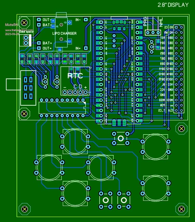

Posts: 9196
Posted: 08:15am 28 Sep 2023
Very Low Spec (VLS) version - just playing last night. This is a machete hack of Peter's circuit. I definitely prefer his approach. :)
Major differences:
Uses a surface mount Pico
Mounting pillars are at least 15mm, with long tail connector for display, to give battery space (stuck beneath display on sticky pads). Wrong battery connector shown.
Uses the SMPS on the Pico but simply shuts it down when charging.
Link selects whether SMPS will shut down, used for programming when USB supply is needed.
Uses a charger & protection module from ebay.
Audio output is crude, headphones only, fixed volume.
No expansion connector
Backlight is on GP28
RTC would require major modification (remove battery & connector. Fit on wires - probably other way round and over expander chip to give more space for battery. RTC battery would be under PCB, like audio jack).
Apologies for the 1206 resistors and caps. :)
I probably won't take this idea any further, but it was fun for a few hours. :)

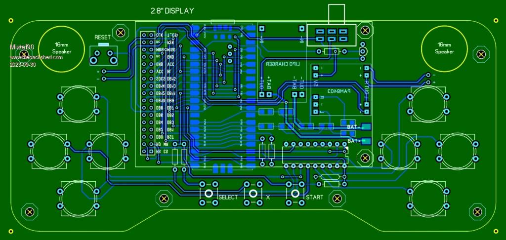

Posted: 06:23pm 29 Sep 2023
Oh, go on...  I had to see if I could do something like that! Note that this isn't a work in progress, merely an experiment. I stole the basic concept from the Atari Lynx, if anyone remembers that.
The board is 160mm by 64mm, so not too big or heavy for a largish pocket.
I couldn't fit the RTC on this time as I included an audio amp (fixed max output volume because the speakers are tiny). Speakers are hot-glued into holes in the PCB. Sound will be pretty ropy, but fine for bangs and crashes. :)
It should manage at least a 1Ah battery. Most things are surface mounted on the underside of the PCB so that the battery can be fitted between the display and the main PCB..
EDIT:
If anyone else is crazy enough to attempt this, the SD card slot is obscured by the RH button pad. It *might* just about be possible to use it to load games into A:. but I'm doubtful.

Posts: 12004
Posted: 10:22am 30 Sep 2023

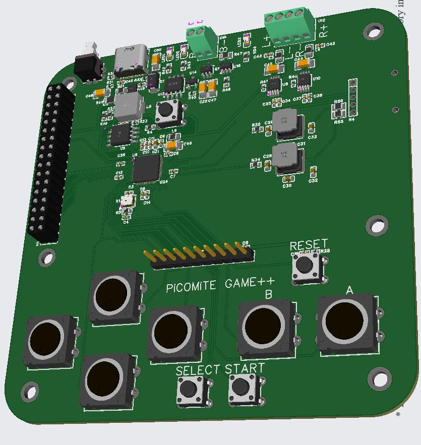

I really like that layout. I've ordered a couple of my design. Once I get them back I can check all the new elements of circuitry - particularly the power section which is all new to me. Assuming all OK I think I will modify it to your layout and then release the gerbers into the wild. Can you let me have the outline as a dxf?
Posts: 9196
Posted: 10:40am 30 Sep 2023
I can't export as DXF from SL6, unfortunately. :(
BMP, JPG, EMF, GIF and Gerber, of course.
Posts: 9196
Posted: 12:21pm 30 Sep 2023
This should work, Peter. I redrew it on CAD.
pergame-2 outline.zip
Another slight mod. GP27 was sitting there all alone and I felt sorry for it. Now it lights the red half of a Red/Green LED, turning off the green half that indicates Power On.
Here endeth the design. I've run out of pins now. :)
Edited 2023-09-30 22:40 by Mixtel90

Posts: 12004

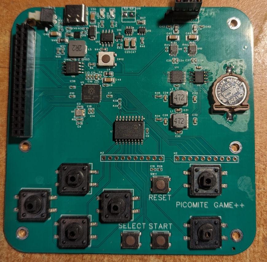

Posted: 06:14pm 11 Oct 2023
It works
Demo here
Speakers out of a defunct laptop
Just a couple of silk screen omissions and the switch was connected incorrectly. Otherwise everything works pretty much perfectly out of the box. The charging/battery protection and load sharing all seems to work but need a soak test.
At the moment the digital pot is upside down so &HFF is off and &H00 is full volume. In addition I need to lower the audio signal before the pot as currently the amp clips at only 33% volume.

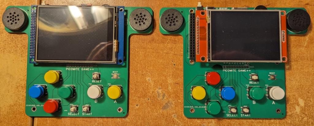

Posts: 9196
Posted: 08:17pm 11 Oct 2023
Nice, Peter. I'm guessing that that's for the 3.2" display? The 2.8" one that I found had no fixing holes at the connector end (not enough height for them).

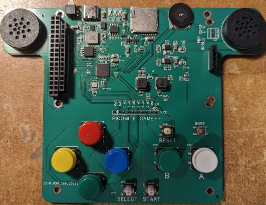

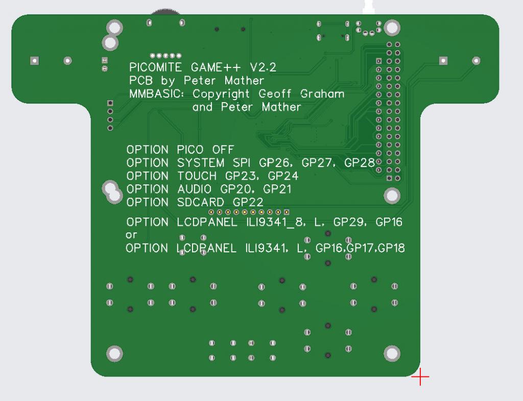

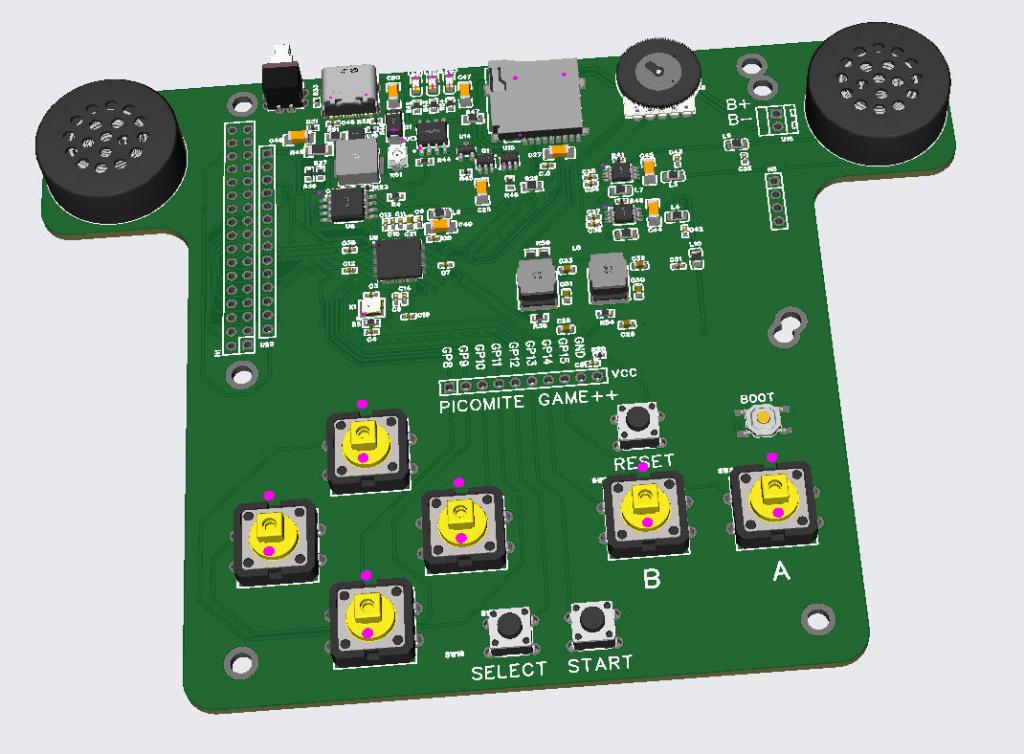

I've had a change of approach since receiving the prototypes and decided to make the board completely compatible with Tom and Mick's
So:
This does away with everything I2C and reverts to their basic idea and will be completely S/W compatible, i.e. Tom's code will run completely unchanged.
The functional difference are stereo audio with manual volume control, no switch needed for charging as proper load sharing circuit incorporated, 3.2" 8-bit parallel display (this one)
Price fully built from JLC GBP123 for 5 including DHL 2-4 day shipping.
