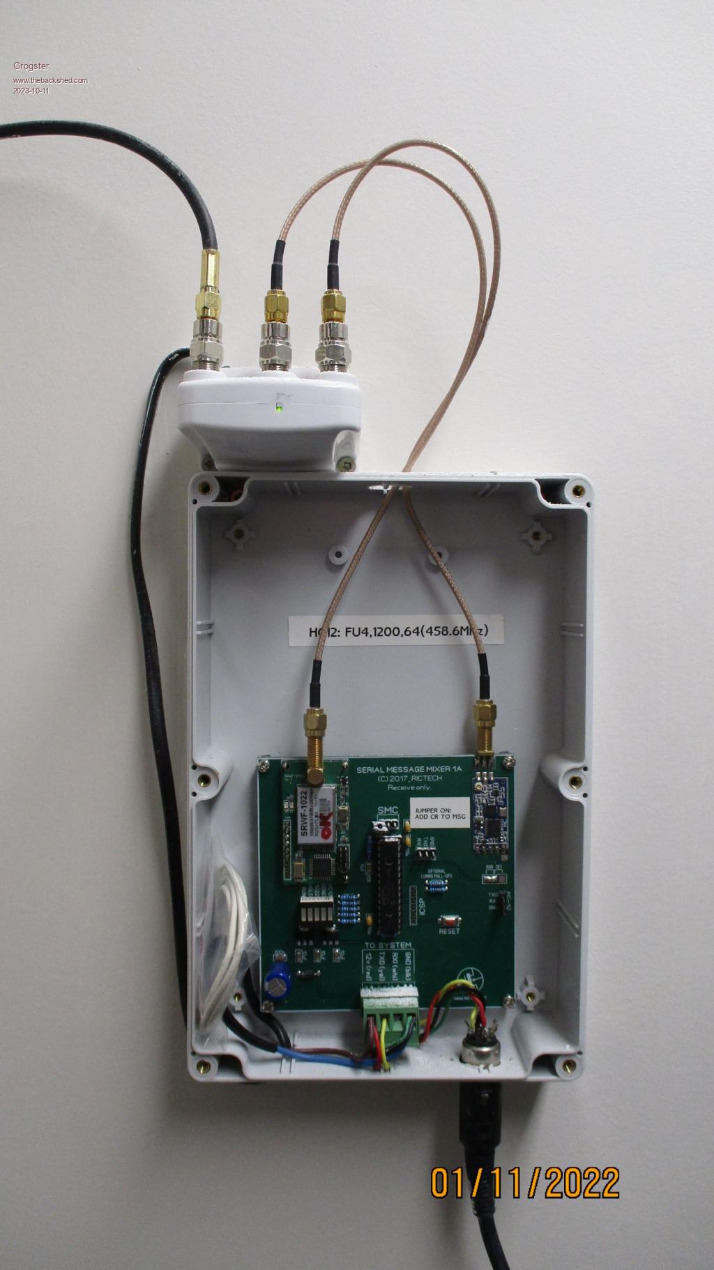

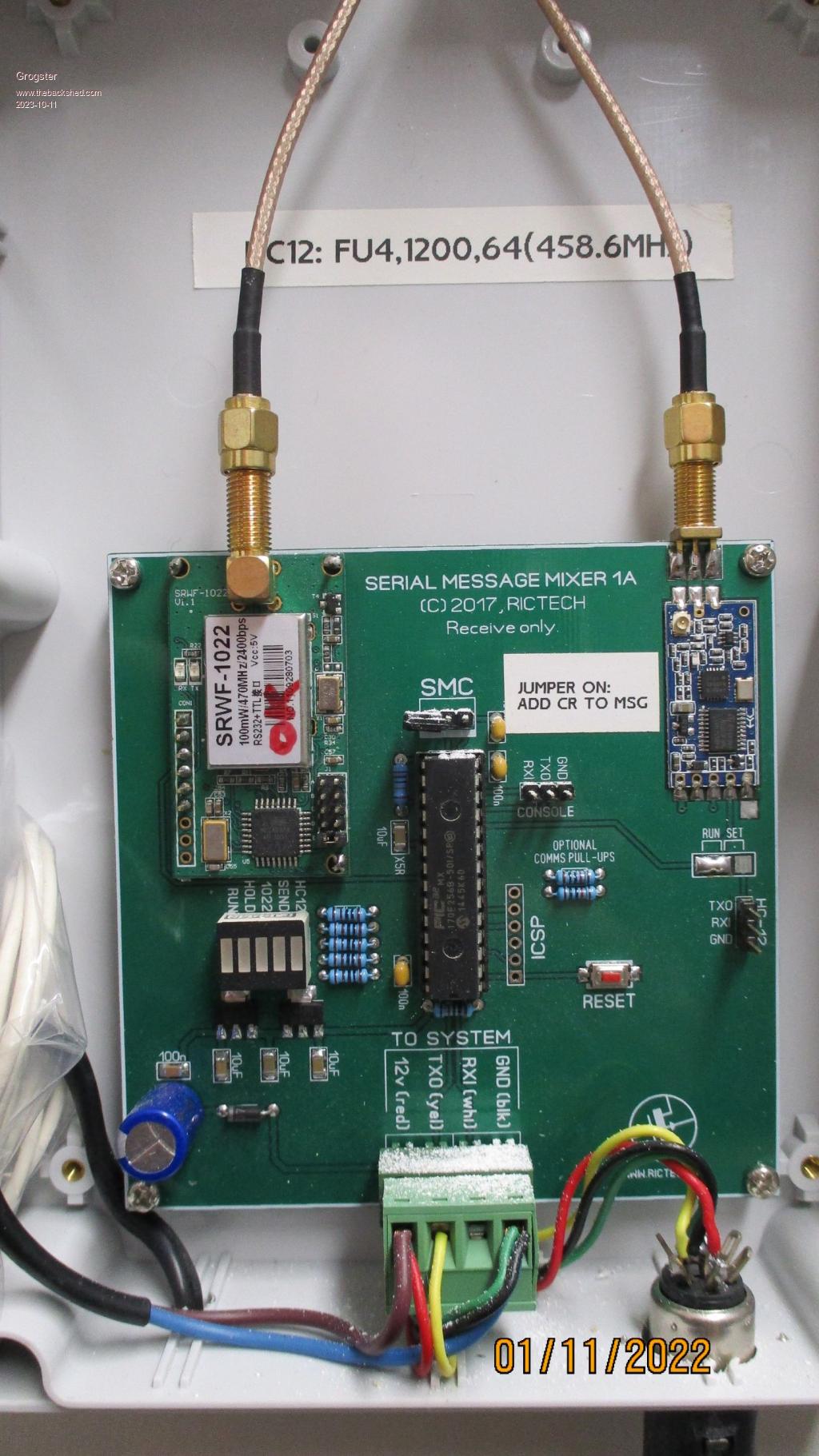

Re: CMM2 sales - yes, I only got five boards made at this stage.  I did not want to stock up on heaps of them, if I can't move them.
As an example of HC12's connected to a roof antenna, look at these photos:
In this arrangement, we have TWO different RF networks, both wanting to talk to the base station.  One network consists of SunrayRF SW1022 RF modules, and the other consists of HC12 modules.
This unit listens to both networks, translates the messages, and sends them out to the base station for processing.
With respect to the HC12's, I have the HC12 module connected to an SMA socket, which is then connected via coax to the output of a TV booster amp(Kingray SA122 from memory), with the input being connected to the base-loaded whip antenna up on the roof.
This arrangement works EXTREMELY well, and I can easily get several kilometers of range from the HC12's when running at 100mW output.
Here in NZ, we very conveniently have a slice of UHF band at 458.6MHz, whic is unrestricted on use and power up to 500mW, so I plopped my HC12 network there, and can run full power to maximize the range, all perfectly legally.
As Mick mentions though, you need to check with YOUR countries regulations, but even with limited output power, this roof antenna arrangement + amp + message mixer should still work very well indeed.  Roof-mounted antennas are still the best.

Posts: 4366
Posted: 07:35am 11 Oct 2023
  Grogster said  As an example of HC12's connected to a roof antenna, look at these photos:
I love the light dusting of ... snow? icing sugar?

Posts: 10009
Posted: 07:55am 14 Oct 2023
  JohnS said  I love the light dusting of ... snow? icing sugar?
Gib-board(Drywall) dust when they drilled new holes for the cables to run through.
