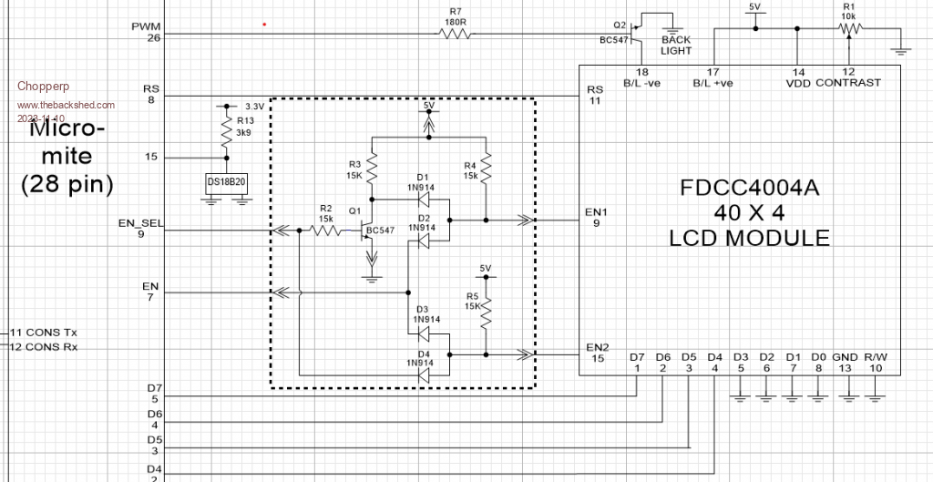

I want to use a 4x40 lcd display ( character type. these are essentiallt two hd44780 controllers with a chip select. one drives the top two lines, the other the bottom 2 lines.
is it possible to create two lcd displays and simply map to different pins ?

Hello vincenthimpe....
You can search in the "thebackshed" search engine for what I was working on, maybe you can start there.
"Kermess" ..... "LCD 40X4 problem."
I don't know how to do it any other way, sorry.
Cheers!
David from Barcelona (spain)
Posts: 3399
Posted: 07:59pm 09 Nov 2023
https://www.thebackshed.com/forum/ViewTopic.php?FID=16&TID=7449#79439

Posted: 09:13pm 09 Nov 2023
great ! thanks. so it's just a matter of manually controlling the enable pin.

Hi
Thanks @vincenthimpe for the post

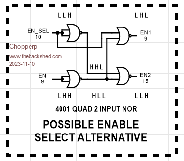

I wish I had had seen @kermess' post back then but it was before my TBS time.  It may have saved me a bit of hassle when I was faced with the same problem. I saw the 40 x 4 LCD on RS many years ago & ordered one.
Robert R's idea of using the O/C outputs is a great idea & allows both sections of the display to be addressed together for some functions as noted e.g. Init & clr. It did not occur to me at the time to do this.
My solution at the time was to used some steering diodes c/w a transistor & resistors with one extra control pin from the 'mite, which combined with the normal EN pin, enabled each section to be addressed separated but, not both at once.
The EN pin enables the interface while the EN_SEL determines which section is selected (0 for top, lines 1 & 2 & 1 for bottom, lines 3 & 4)
I also wrote some pseudo code routines to replace the normal LCD commands.
I may get around to changing to the other solution which is simpler but does use one more pin. I haven't actually used the setup for a while now.
Circuit & code (which may not be elegant, but works) are shown below for interest. I did draw up a later untried version just using a 4001 quad 2 input NOR IC
' Some preamble
dim integer d4 = 5, d5 = 4, d6 = 3, d7 = 2, rs = 6, en = 7, en_sel = 9, en1 = 0, en2 = 1 'LCD variables
'LCD Setup 40x4 display treated as 2 x 20x2 displays. Subroutines used to emulate normal LCD Cmds.
'set cursor value below as:   12 = 0ff
'                             13 = blinking ON OFF #
'                             14 = solid "_"
'                             15 = blinking solid "_#"
cursor = 12         'set cursor OFF
lcd_init d4,d5,d6,d7,rs,en    'Pins 5,4,3,2,6,7  initialise the LCD
'* NOTE LCD INIT in LCD_CLOSE routine
%%%%%%%%%%%  LCD ROUTINES  %%%%%%%%%%%%%%%%%%
'  'The 40 chr x 4 line LCD has to be treated as 2 separate LCD's or sections.
'  'MMBasic requires a LCD Close before an initialzation.
'  'The first section is selected & then initalised "LCD INIT".
'  'The second selection is then selected then the CLOSE command sent which
'  'satisfies MMBasic.
'  'The LCD INIT is then sent to the second section
sub LCD_INIT (d4,d5,d6,d7,rs,en)  '4 data bits plus select & enable
pin(en_sel) = en1                 'first section - top 2 lines or rows
LCD init d4,d5,d6,d7,rs,en        'Initialise section section
lcd_cmd 1, cursor                 'set cursor mode top section
pin(en_sel) = en2                 'second section -3rd & 4th lines
lcd close                         'Terminate function in MMBasic
lcd init d4,d5,d6,d7,rs,en        'Initialise section section
lcd_cmd 3, cursor                 'set cursor mode bottom section
end SUB
