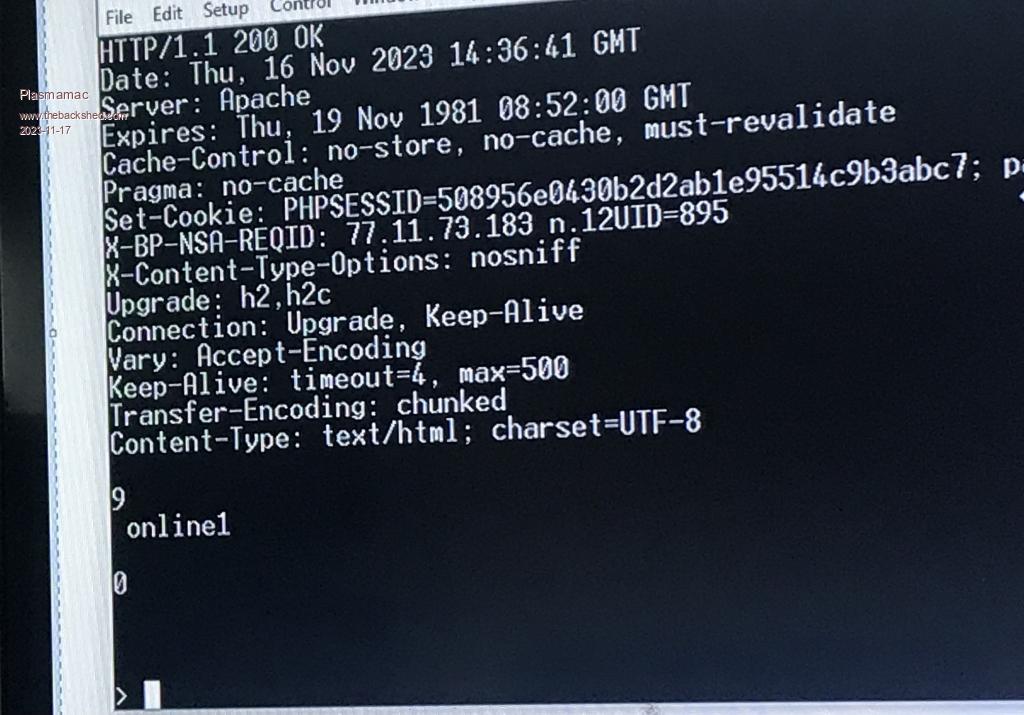

Well, I've got this far...
Function getTest(servaddr$,servport,tcpreq$) As string
 Local return%(64) ' 512 chars
 WEB OPEN TCP CLIENT servaddr$, servport%
   WEB TCP CLIENT REQUEST tcpreq$+" HTTP/1.1"+Chr$(10)+Chr$(13), return%()
   getTest$="done"
   LongString Print return%()
 WEB CLOSE TCP CLIENT
getTest("192.168.0.32",8081,"GET /status/ldata.php")

  JohnS said  It may not -probably does not - like that you send LF then CR.
(Being chr$(10) then chr$(13).)
A previous webserver didn't like them in the wrong order.
Spot On John!
getTest$="GET "+tcpreq$+" HTTP/1.1"+Chr$(13)+Chr$(10)+"Host: "+servaddr$+":"+Str$(servport)+Chr$(13)+Chr$(10)+"Connection: keep-alive"+Chr$(13)+Chr$(10)+Chr$(13)+Chr$(10)
WEB TCP CLIENT REQUEST getTest$, return%()
LongString Print return%() ' for now
End Function
Now works like a charm.
Calling getTest("192.168.0.32",8081,"/status/ldata.php") spits back exactly what I expected.
Cheers, Chief.

Plasmamac
Joined: 31/01/2019
Posts: 620
Posted: 02:53pm 16 Nov 2023
Thx a lot
Works like a charm
Plasma
