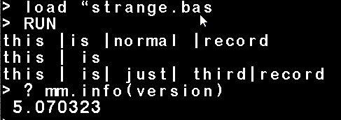

@Peter,
It seems there is some problem. While reading text file (printscreen 03b23, tested also on 03b24 )
It does not input line if meets coma ->> ,
Please check attachement
strange.zip
Edited 2025-02-06 05:10 by electricat
My MMBasic 'sand box'
Posts: 6638
Posted: 09:02pm 05 Feb 2025
Use LINE INPUT if you want the full line including any commas
Posts: 3429
Posted: 09:25pm 05 Feb 2025
  manual said  INPUT ["prompt$";] var1 [,var2 [, var3 [, etc]]]
Will take a list of values separated by commas (,) entered at the console and will assign them to a sequential list of variables.
INPUT #nbr, list of variables
Same as above except that the input is read from a serial port or file previously opened for INPUT as ‘nbr’. See the OPEN command.
electricat
Joined: 30/11/2020
Location: Lithuania
Posts: 299
Posted: 09:28pm 05 Feb 2025
  TassyJim said  Use LINE INPUT if you want the full line including any commas
Thanks! Line input works. And now i see already about comas in user manual explanation.
